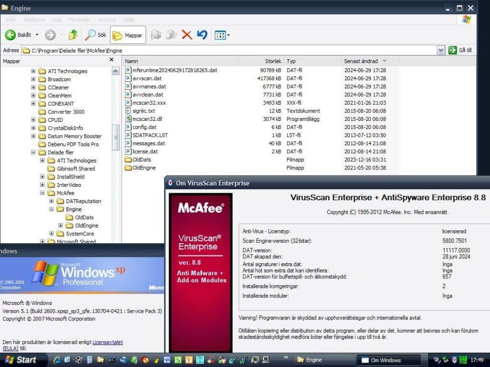

Yes and yes... I fired up my old T43 with a fan that sounds like a chainsaw and dead Ethernet but it has an uncrippled install of Enterprise 8.8. Downloaded 11117xdat today to the A31 and copied it to the T43. Ran it and the logfile didn't show any errors. The file mscan32.xxx you see in the picture is engine 5900 but the zip I found at the time didn't work. I think I'm ´missing some other files.
Thanks for testing! However, it is quite unusual that the virus definitions of McAfee VirusScan Enterprise 8.8 with such an old scan engine can still be updated in these days. BTW, for updating the scan engine to version 5900, you can try to use this which I found by accident: https://download.nai.com/products/licensed/engine/intel/5900/ I don't know whether this scan engine update is the right one for your installation, though.
