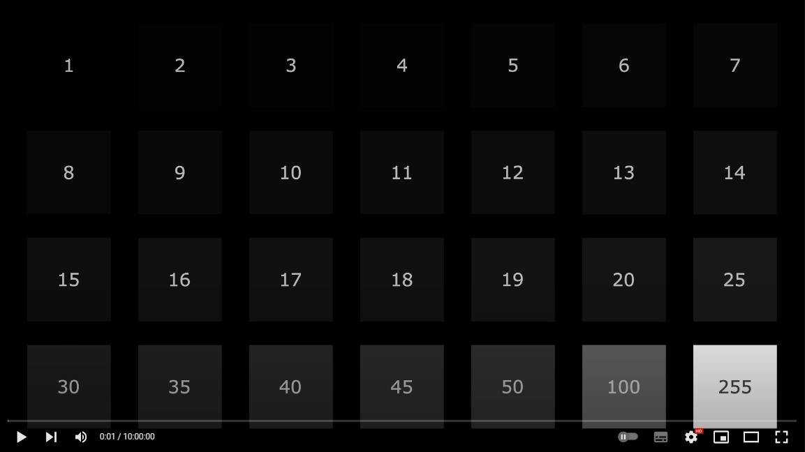

Ok, thanks for testing, so I need to look into why this happens only for me then. Some screenshots:
Firefox:
Opera:
I have also found the topic where a missing function in Win7 is mentioned, which is DX11 DXVA, but the topic is 6 years old already so I don't know if that is relevant anymore. I will try to disable hardware video acceleration to see if that makes a difference.

So I just put media.hardware-video-decoding.enabled to false, restarted the browser and am getting different results now:
Also verified there's no video engine load while playing the video so it should be software decoded now. Interesting thing is, while this isn't washed out anymore this is actually still different from what Opera is outputting, the white is brighter and in comparison it now seems that Opera has a red tint to the greys? If you download these images and flip through them you can see what I'm talking about. So, is Firefox rendering it correctly now while Opera was giving me bad video too all along? Also as a side remark, media.hardware-video-decoding.failed was already at false and is listed as a changed setting, for whatever that's worth.
PS: it just occurred to me that I had h264ify on for Firefox the entire time while it was off for Opera, so I thought this might be related, because Opera was getting an AV1 video previously. However I just turned it on and it doesn't seem to be the cause, here a quick screenshot from Opera to prove it:
Edited by test5362
I would suggest that it is your OPERA screencap that is "discolored".  A true black should have RGB values equal to each other, which your Firefox screencap has but the Opera screencap has all of the Gs decreased.
I've looked at the black RGB values in MyPal27, NM27, NM28, St52, St55, Official Firefox 112, 360Chrome v13.5, VLC Player v2.2.8, and Opera 95.
Opera is the only RGB with unequal RGB values (G is always decreased) - I don't use Opera enough to know if this is "by design".
The numbers for one app will not agree with another app, but the RGBs always equal each other - except in Opera.
