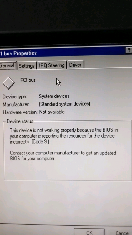

JukeBoxHero Posted April 18, 2023 Author Posted April 18, 2023 Think I found something contributing to this issue
Damnation Posted April 22, 2023 Posted April 22, 2023 @bob_smith Yeah, that would have something to do with the issue. Not sure about this one though, try disabling IRQ steering?
jumper Posted April 22, 2023 Posted April 22, 2023 Under IRQ Steering, first deselect Get IRQ table using ACPI BIOS. What does the IRQ Routing Status say?
pangoomis Posted April 23, 2023 Posted April 23, 2023 Catalyst 6.2 for 98SE/ME does have support for PCI\VEN_1002&DEV_5954 Try reinstalling 98SE with "setup /p i" switch to disable ACPI.
