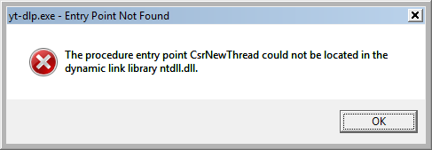

3 hours ago, user57 said:
Csr functions useally came from csrsrv.dll
i think CsrNewThread is just a different name for CsrCreateThread
those are often very similiar to CreateThread or NtCreateThread
it would be about looking its parameters and purpose for exact detail, but xp has many of these functions
https://www.geoffchappell.com/studies/windows/win32/csrsrv/api/process/thread.htm
no it do something different:
https://doxygen.reactos.org/d6/dad/sdk_2include_2reactos_2subsys_2csr_2csr_8h.html#a37b4505763dfb64bf489339460ae04e8
there CsrNewThread is just a redirection to NtRegisterThreadTerminatePort
if thats all you just have to use NtRegisterThreadTerminatePort, xp has that function
no, CsrNewThread also passes an internal variable to NtRegisterThreadTerminatePort. so you can't just use NtRegisterThreadTerminatePort to replace CsrNewThread
Edited by roytam1
Posted (edited)
right
NTSTATUS
NTAPI
CsrNewThread(VOID)
return NtRegisterThreadTerminatePort(CsrApiPort);
while CsrApiPort is defined as HANDLE (HANDLE CsrApiPort;)
in this case that CsrApiPort variable is empty
Edited by user57
