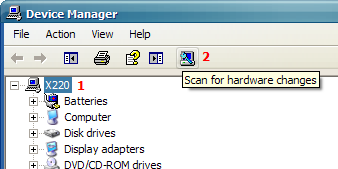

I have my own way to change the driver in WinXP and it always works - have been using it for many years:
  • uninstall driver from Device Manager
  • search oemx.inf file for the previous installed driver in WINDOWS\inf directory then delete this file (delete also same name oemx.PNF but not necessary)
  • in Device Manager click the computer name at the very top and then Scan for hardware changes button
  • now WinXP finds new hardware where you need to indicate the location of the new driver and install it
