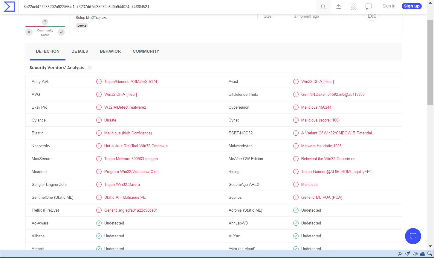

AstroSkipper Posted August 14, 2022 Author Posted August 14, 2022 (edited) 31 minutes ago, Dave-H said: No ideas to offer I'm afraid, this is not something that I have any knowledge about, but FWIW none of the versions of your programs I've used triggered any warnings for me. I'm using Malwarebytes premium, which has real-time scanning. Thanks for your observation! It's all a bit strange. You said Malwarebytes premium didn't trigger any warnings for you, but the Malwarebytes online scanner on VirusTotal does! Check, for example, the file StartProxy.exe, and you'll see what I mean! Edited August 14, 2022 by AstroSkipper Update of content 1
AstroSkipper Posted August 14, 2022 Author Posted August 14, 2022 (edited) 1 hour ago, AstroSkipper said: 4 hours ago, AstroSkipper said: Just a short feedback! I tried different compilers, but with moderate success. Some of my compiled program files are repeatedly classified as malware by various AV scanners, although they are absolutely clean, of course. I tried several variations of my programs' source codes. I am a little perplexed at the moment. Presumably, these false positives are caused by the misuse of these compilers by script kiddies or other hobby hackers. Actually, I would like to reduce these false positives from the established AV scanners. Any advice or tip is welcome! Cheers, AstroSkipper Expand I forgot to mention that I referred to compilers which convert batch files to executables. I believe that the real problem lies in code snippets that are often used by script kiddies or hobby hackers. If this code appears in clean programs, then some AV scanners generate these false positives. Any further ideas? And, after some tests using different compilers, it also seems to depend on the compiler itself. Converted files by a frequently used compiler trigger more false positives than those by a less used one. That was kind of to be expected and makes sense! Edited August 14, 2022 by AstroSkipper addition 1

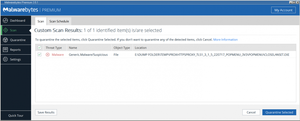

Dave-H Posted August 14, 2022 Posted August 14, 2022 As a test, I extracted your files to a temporary folder, and scanned the folder with Malwarebytes. As you can see, it was suspicious about closelanset.exe. Quite why it would be suspicious of that I'm not sure, but I guess it considers opening Windows Control Panel applets to be suspicious behaviour, which is perhaps fair enough! Why it didn't also flag openlanset.exe is a mystery though if that's the case! Stranger still, if I scan the folder containing the actually working versions of the files, it finds absolutely nothing wrong at all, even when I then scan just the closelanset.exe file! 1

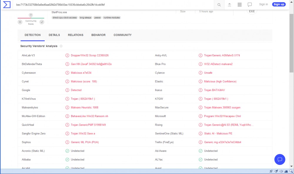

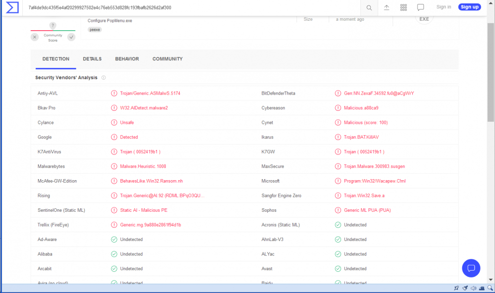

AstroSkipper Posted August 14, 2022 Author Posted August 14, 2022 (edited) 4 hours ago, Dave-H said: As a test, I extracted your files to a temporary folder, and scanned the folder with Malwarebytes. As you can see, it was suspicious about closelanset.exe. Quite why it would be suspicious of that I'm not sure, but I guess it considers opening Windows Control Panel applets to be suspicious behaviour, which is perhaps fair enough! Why it didn't also flag openlanset.exe is a mystery though if that's the case! Stranger still, if I scan the folder containing the actually working versions of the files, it finds absolutely nothing wrong at all, even when I then scanned just the closelanset.exe file! Thanks again for your tests and observations! Now you may understand what I mean. It's very strange and gets stranger if I modify code or use another compiler. A little change of a code snippet, and my Avast doesn't trigger a warning, and so on. I hate that! Please, try to scan StartProxy.exe, Confgure PopMenu.exe and SetupMin2Tray.exe on VirusTotal! What do you think about the results? Edited August 14, 2022 by AstroSkipper correction 1
Dave-H Posted August 14, 2022 Posted August 14, 2022 This is what I'm seeing. I assume you meant configure popmenu.exe, not configure proxy.exe, which doesn't seem to exist.
AstroSkipper Posted August 14, 2022 Author Posted August 14, 2022 (edited) 41 minutes ago, Dave-H said: This is what I'm seeing. I assume you meant configure popmenu.exe, not configure proxy.exe, which doesn't seem to exist. Sorry, you're righr! Confgure PopMenu.exe, of course! Too much proxy in my head! I already know these results, and that wasn't the problem, either. I am interested in your opinion about these results. Edited August 14, 2022 by AstroSkipper Update of content 1
