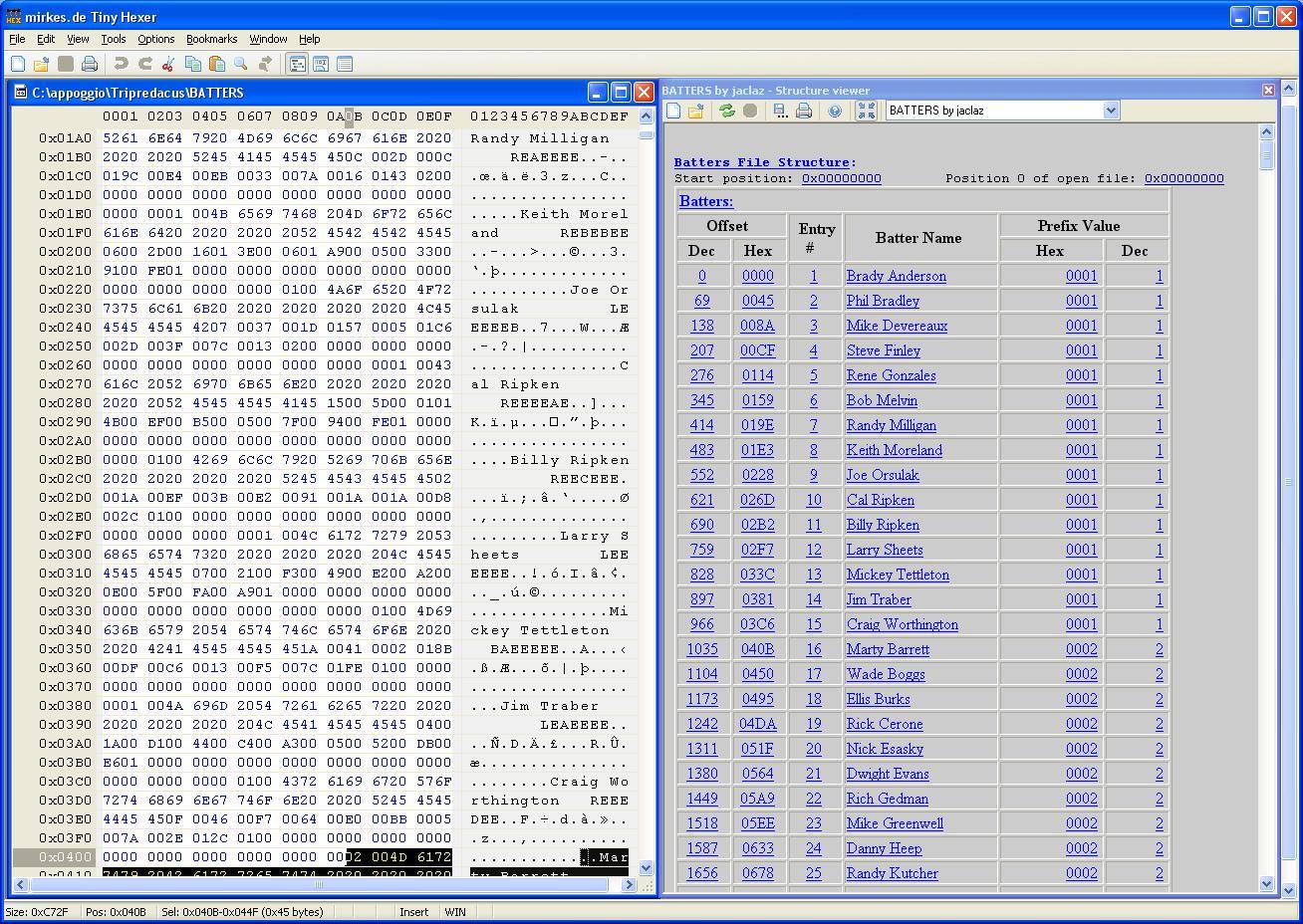

jaclaz Posted August 23, 2019 Posted August 23, 2019 (edited) Ok, in the meantime get TinyHexer from here: https://www.softpedia.com/get/Others/Miscellaneous/tiny-hexer.shtml Put the attached ,mps in the \mirkes.de\Tiny Hexer\scripts\Structure Viewer folder and use it on the BATTERS file. There is a little glitsh as the single quote character in the batter name makes things "go green", but it is only a visual one. Of course I need BOTH the "stock" and the "modified" files to go on. jaclaz BATTERS.mps Edited August 23, 2019 by jaclaz

Tripredacus Posted August 26, 2019 Author Posted August 26, 2019 The duplication of next batters does not appear in the raw data. There is no repeating of data that I can see. Easier to see differences using the Address2016 file rather than the default one. 1
jaclaz Posted August 26, 2019 Posted August 26, 2019 (edited) You are right, I was *somehow* parsing the same range twice , but the record size is correct, 50 bytes. What throws off manually viewing the file is that some entries have 00's, i.e not all entries are "populated". Attached the corrected Address.MPS, replace the old one with this (no more the "whatever" field ) Now, in "Address" Entry # should be the Team #, whilst in "Batters" and "Pitchers" the "Prefix" should be the Team #. I.e. in Batters, Batter #589 Roy White should belong to Team #42 (value of "Prefix"). And in Address, in Entry # 42 there is (last filled entry in Batters) #589. As well, in Pitchers, Pitcher #387 Mike Torres should belong to team #42 (value of "Prefix"). And in Address in Entry #42 there is (last filled entry in Pitchers) #387. jaclaz ADDRESS.mps Edited August 26, 2019 by jaclaz 2
