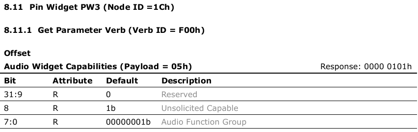

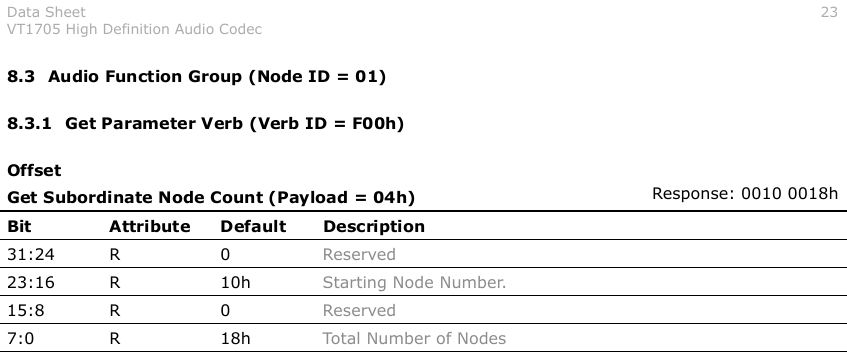

deomsh Posted March 11 Posted March 11 (edited) Great progress! Regarding pcipatchB: maybe Linux sources can be used to make additions to your list (search for 'pci quirks'). 13 hours ago, isolar said: Nodes $19-$1E & $22-$23 also reply as Audio Function Group with unsolicited caps? - very strange. Total of 8 nodes reporting this. Why strange? Widgets will sent unsolicited responses (if this is enabled). Same widgets noted in the Datasheet of VT1705: seven Port's and one (unknown) Vendor Widget. 13 hours ago, isolar said: $000F0004 (root) responds that there is only 1 connected AFG node which is node $01 (AFG) - correct. Then $001F0004 responds that the highest node number is 24 (18h) with the first node being 16 (10h). So 9 widget nodes connected to the AFG. 8 of these report they are AFG with unsolicited caps? I don't see your math: highest node number will be 10h + 18h - 1 = 27h (highest mentioned in the Datasheet is actually 27). I don't know wich mechanism the codec will use to translate and sent the unsolicited response to the RIRB. Only 'Software' (i.e. the driver) can do something with it. I never 'reached' this level, but you will (soon). Better ask Copilot or study Intel's High Definition Audio Specification. P.S. maybe I mis-read your question about why these other Widgets identifies themselves as AFG too. I looked into it for Widget 0x1C (on VT1705) I am currently investigating to find something useful for @Drew Hoffman . So I looked for an explanation in Intel's High Definition Audio Specification: '7.3.4.4 Function Group Type The Function Group Type parameter returns a value describing what the type of node is being addressed. This parameter is primarily useful for identifying the type of Function Group a node represents (such as Audio versus Modem) but can also be used to identify the type of “Other” or vendor specific nodes. Parameter ID: 05h' And so on... Maybe of interest if searching with other Codec ID than already established as AFG? To be honest, I can't remember I ever realy thought about it. In my humble opinion bytes [0:7] give no useful information here, but byte [8] does in case of targeting 'Software' (I suppose). BTW if some MSFN-members - reading this thread - are still not convinced of the usefulness: each print-screen selection made with WinKey+Shift+S and mouse and directly pasted above, without any extra (visible) use of other programs (Windows 10 , Windows 11 is different - maybe possible to change to 'old' style?). Edited March 11 by deomsh P.S. + typo's

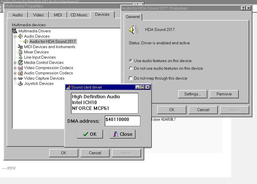

deomsh Posted March 21 Posted March 21 (edited) That's sad. Do you want to proceed with this driver, or are you finished? On the other hand there is WDMHDA in development of @Drew Hoffman(Windows 98 SE). Edited March 21 by deomsh
isolar Posted March 22 Posted March 22 Some more success! Widget parser is now working correctly to establish correct line out pin, mixer pin and DAC to obtain playback path. Analog only, digital is skipped. Automatically checks and sets the connections. Automatically sets stream and channel settings. Automatically sets volume based on 0dB step level. Automatically enables EAPD if required. Automatically applies PCI patch if required (on 0280 codec). Tested and working on Realtek 0280 codec, Realtek ALC272 codec, and IDT 92HD75B3X5 codec - All installed from scratch and produce sound automatically, no config required. IDT codec note that may be of use to @Drew Hoffman - I found this particular IDT codec provides the output amp caps from the AFG node rather than the DAC node which Realtek does. I read DAC first and if output amp caps are zero I fall back to reading the AFG and applying 0dB to the DAC. Unsure what other codecs do it this way. Next step I will integrate auto headphones with jack detect, then look into microphones. Any other suggestions? 1
