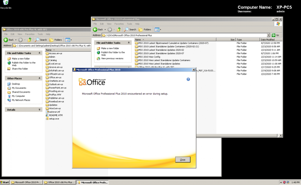

InterLinked Posted August 7, 2020 Posted August 7, 2020 4 hours ago, Dave-H said: Sounds right. My MSO.DLL file is exactly 18,640,016 bytes, if yours matches that, it must be it! Drop the 86 off the file name, and check its version, it should be 14.0.7214.5000. @Dave-HOK, something weird is up. I try to install and I get "..encountered an error during setup." The same files I have used to install MSO 2010 SP2 on W7 and Vista with no issues.
Dave-H Posted August 7, 2020 Author Posted August 7, 2020 What are you actually installing when you see the error?
InterLinked Posted August 7, 2020 Posted August 7, 2020 (edited) 58 minutes ago, Dave-H said: What are you actually installing when you see the error? Microsoft Office 2010 Professional Plus, running setup.exe Begins but then fails a minute later, every time Same in Safe mode, when it fails even more quickly Happens even with all updates and SP2 removed, not sure what's up. Edited August 7, 2020 by Dylan Cruz
Dave-H Posted August 7, 2020 Author Posted August 7, 2020 Oh right, so you can't install Office 2010 at all! Is there anything in the Windows Event logs which sheds any more light on what's happening? Office does use the Microsoft Installer, which is usually pretty good at logging what it's doing. You may well find further logs in your Windows TEMP folder.
InterLinked Posted August 7, 2020 Posted August 7, 2020 (edited) 6 minutes ago, Dave-H said: Oh right, so you can't install Office 2010 at all! Is there anything in the Windows Event logs which sheds any more light on what's happening? Office does use the Microsoft Installer, which is usually pretty good at logging what it's doing. You may well find further logs in your Windows TEMP folder. Indeed: Error: MsiInstaller What the heck? No idea what this could mean! Failed to connect to server. Error: 0x80080005 For more information, see Help and Support Center at http://go.microsoft.com/fwlink/events.asp. Also in another log: The server {000C101C-0000-0000-C000-000000000046} did not register with DCOM within the required timeout. For more information, see Help and Support Center at http://go.microsoft.com/fwlink/events.asp. Edited August 7, 2020 by Dylan Cruz
