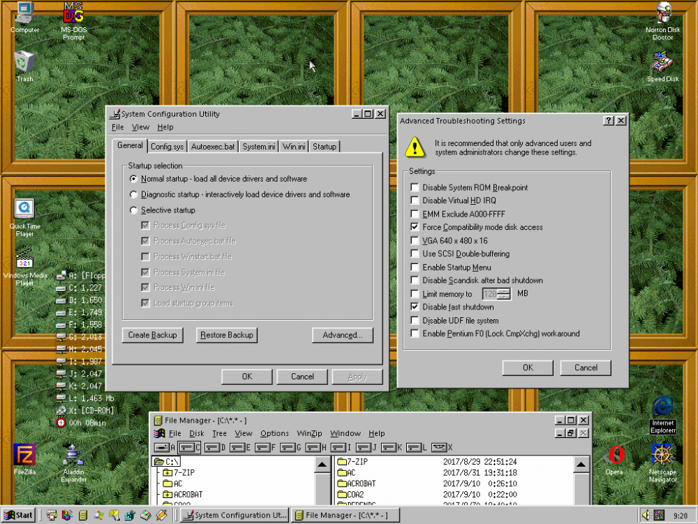

The DOS multibooting procedure between DOS, OS/2 and Windows 95 has became a wonderful project of mutibooting between these OSes under Virtual PC 2007.
However, for one OS, I'm running into issues here.
I have Windows 95 installed on the third hard drive. Using GRUB4DOS, I had to hide the MS-DOS hard disk image on (hd0) and the OS/2 Warp hard disk image on (hd1).
I then mapped the third hard disk image where Windows 95 is installed on (hd2) as (hd0) and although the OS work fine, it's showing original drive letters, M, N, O and P as phantom hard drives and drives C, D, E and F using MS-DOS compatiblity mode file system.
Here are some screenshots for proof of this issue:
Windows Explorer showing drive letters M, N, O and P as phantom drives.
Device manager listing drive letters M, N, O and P in the current drive letter assignment in System Properties > Disk drives.
System Properties > Performance reporting drives C, D, E and F using MS-DOS compatibility mode file system.

Posted (edited)
Adding the map --hook parameter actually threw a "Non system disk or disk or disk error" message. Pressing the ENTER booted the OS from the third hard disk image as usual. If I remove the --map hook parameter, Windows 95 without any problems.
Look here:
What I did was to enter the "System Configuration Utility" (msconfig), click Advanced and select "Force Compatibility mode disk access" which will force Windows 95 to use real mode disk access since it is in a dual boot environment with MS-DOS and OS/2.
The result is that drive letters M, N, O and P are now gone! :)
As far as I know trying to mess around with the GRUB4DOS MENU.LST settings corrupted as much as 209 MB of data on the MS-DOS 6.22 partition and had to reinstall DOS! That's one of the reasons why I had to back up data incase something goes wrong.
Edited by ppgrainbow
