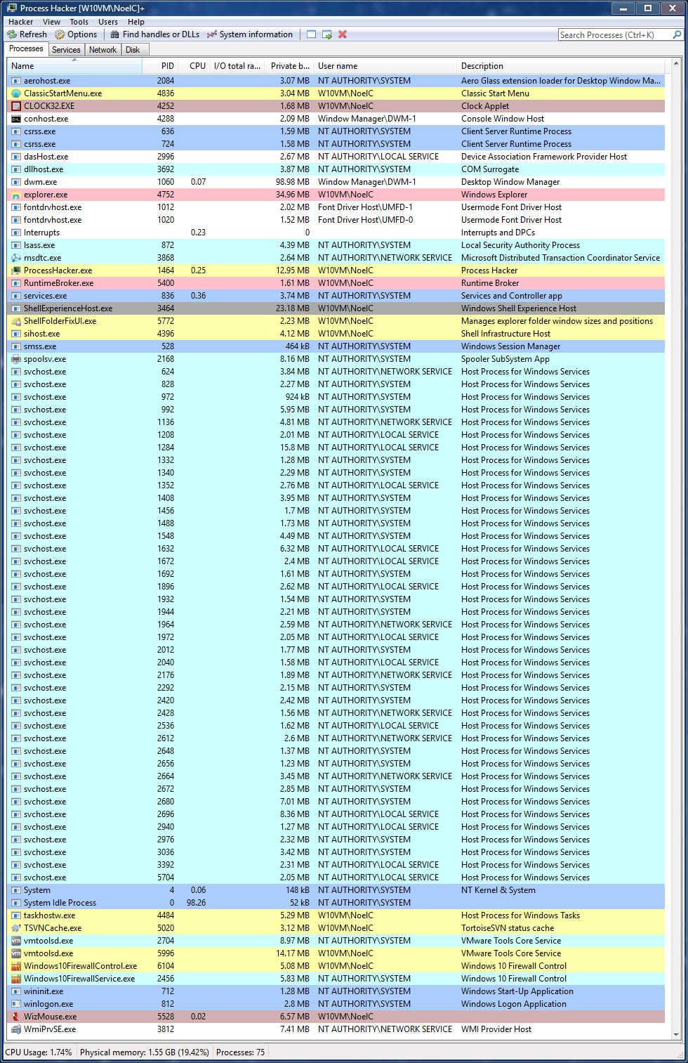

NoelC Posted April 22, 2017 Posted April 22, 2017 (edited) On 4/20/2017 at 8:56 AM, abbodi1406 said: Chopping and updating Windows 10 is a lost cause you can have one of them, not both We may have a difference in what you mean by "chopping". I have a trimmed and functional Win 10 v1703 build setup now and I can apply cumulative updates no problem. It leaves me to wonder, what parts do I still have that are not in your ideally "chopped" system? I've removed all Apps, and have reduced the services and scheduled tasks considerably. To support an idle desktop it's running 75 processes and using about 1 GB of RAM. Is this substantially different than the goals in this thread? Have I chopped less deeply? Note that I started by removing things from a full ISO installation done as an in-place upgrade from the prior v1607 system I have been maintaining in a VM since before Win 10 was initially released. Since I was successful at this I'm actually starting to consider whether the ongoing advantages of "keeping current" are starting to outweigh the advantages of sticking with the older system (Win 8.1) I'm still using on my hardware. -Noel Edited April 22, 2017 by NoelC

abbodi1406 Posted April 22, 2017 Posted April 22, 2017 Win 10 v1703 cumulative update is still lite, so it won't fail for now by chopping i mean removing internal packages and "nLiting" the OS extensively how did you reduced your OS?
NoelC Posted April 23, 2017 Posted April 23, 2017 (edited) 6 hours ago, abbodi1406 said: how did you reduced your OS? Generally speaking: By removing AppX packages, removing other features (e.g., OneDrive), disabling many services, disabling many scheduled tasks - all on the online system that's running. I wrote a re-tweaker script that does a lot of it. One thing I'm NOT concerned with is making the system footprint on disk smaller; even SSD space is far too cheap to try to delete things that the OS wants to see remain there. Notably I'm very careful to ensure the system thinks it's still serviceable (e.g., SFC and DISM /Online report no problems). I have been doing it this way for many years. So far I've never had any failure to update. -Noel Edited April 23, 2017 by NoelC 2
