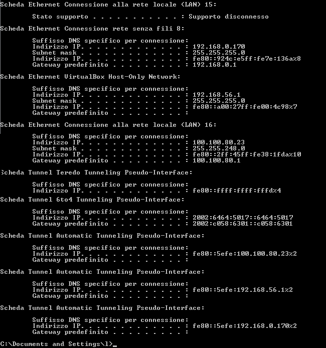

@Sampei.Nihira Well, thanks, but I already configured ipv6, in fact, it works flawlessy within the intranet, but it doesn't work in internet.
As you can see, ipv6 is configured and I got both an ipv4 and an ipv6 address. Teredo Tunnelling is configured as well as 6to4 interface.
So... the question is: what am I doing wrong? Why do I get an ipv6 address, but testipv6.com fails to detect it (and ipv6 only sites don't work?).

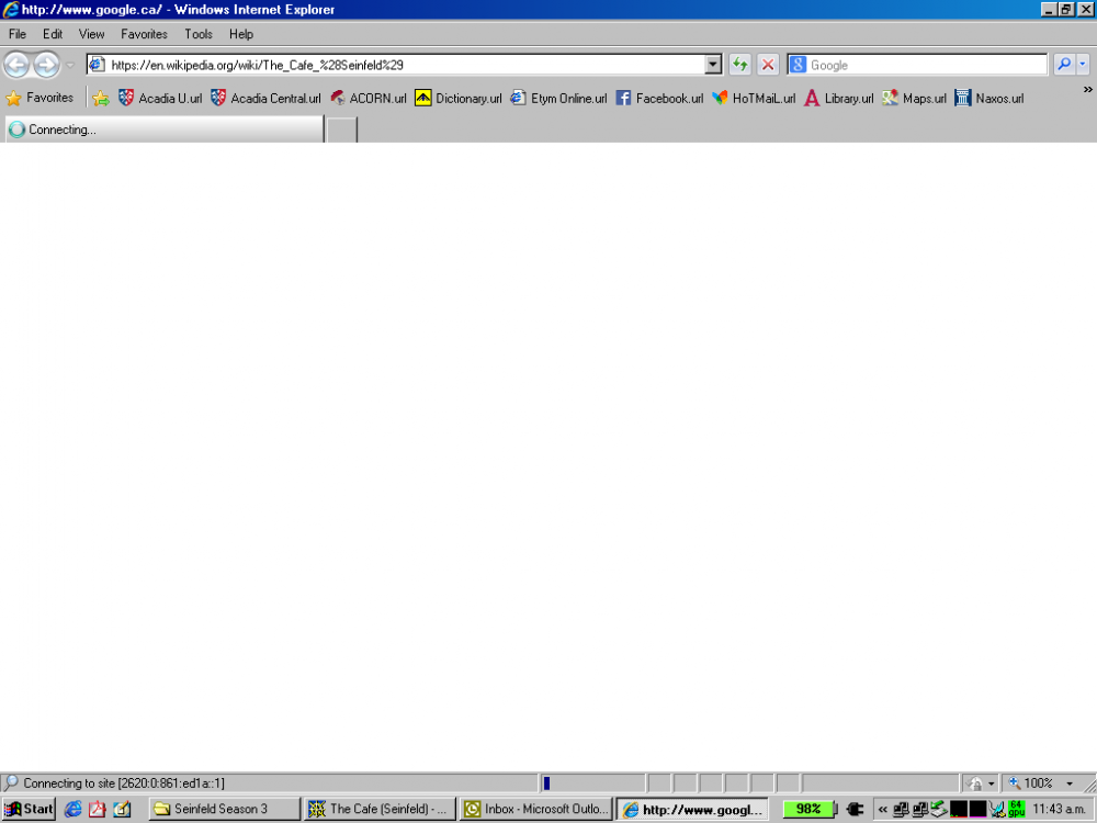

I'm just a user, but even using MSIE 8, [edit: even using MSIE 6!]  I now often see IPv6 addresses in the status bar when loading Google, so it just works for me when Web browsing at least.
Not sure if that is even what you are talking about but that is my experience!

All I have for you is this screenshot (check out the status bar).
I have witnessed this on Wikipedia and increasingly on Google.
