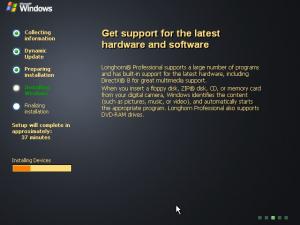

Here is a screenshot of a test bbu:

  • Author
Now you can download the updated command line version above, which also works with SP2 and other versions (like LH4074 bbu).
Below I also provide a easier GUI version.
bbudlg_nvc.zip
