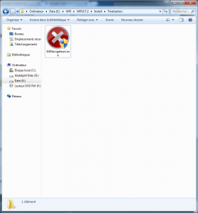

Note: I converted the ".bat" file ".exe" to make disappear the command window that opens after execution  :rolleyes:

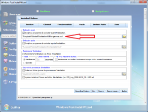

There is a section in the options menu I suggest you try. It is execute before and execute after. It might be a little messy to you but have a command run your bat file and exit so WPI sees the file start and end. Then have execute after end the original file. I can't do pictures yet my pc is down at the moment.

There is also a option you can put during each entry to kill processes. That way when you have program c start a process then you can have WPI kill said process. Look in the drop down area when configuring a app

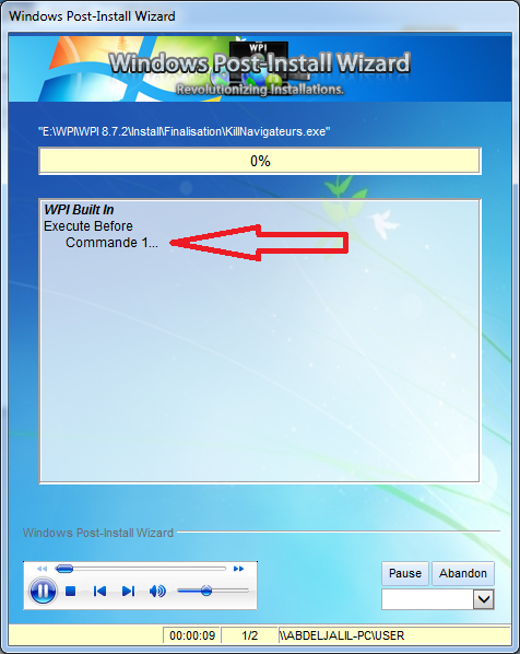

it's the same problem, WPI remains blocked in the first program instead of continuing with the installation of other programs
I try the command "{TASKKILL} prog.exe" but there's a problem, sometimes the command is executed before the opening of a browser which is a problem, that's why I create a batch file to resolve this issue

post-411164-0-42719400-1448277260_thumb.
post-411164-0-57523000-1448277268_thumb.

I found the solution: I put my "Kill Navigateurs.exe" file in a winrar sfx files I gave him the order to run it from the temporary windows folder after decompression and to pursue wpi installation without problems :thumbup
