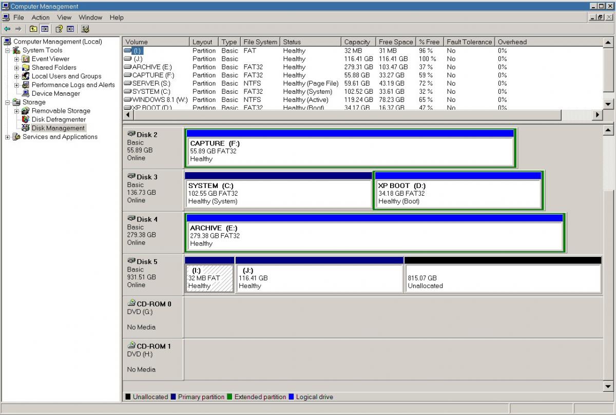

Dave-H Posted January 28, 2015 Author Posted January 28, 2015 Tried again in XP.Same result -Microsoft Windows XP [Version 5.1.2600](C) Copyright 1985-2001 Microsoft Corp.C:\XP User Files\Dave>i:I:\>switcher"DUAL" disk found as \\.\PHYSICALDRIVE5OK, NTFS volume is mounted to drive J:and it uses a 512 bytes/sector interfaceCurrent NTFS bootsector is NOT the 512 bytes/sector one.Do you want to switch to the 512 bootsector? [Y/N]yIf you are on Vista or later you may need to authorize the copy (UAC prompt).OK, written 4096 bytes at offset 0Press any key to continue . . .I:\>Drive J: still reporting unformatted, and the same layout in Disk Management.

Dave-H Posted February 4, 2015 Author Posted February 4, 2015 OK, ran the check and got this, so it looks as if all is well.Microsoft Windows XP [Version 5.1.2600](C) Copyright 1985-2001 Microsoft Corp.C:\XP User Files\Dave>i:I:\>dsfo \\.\J: 0 4096 mycurrent.bssmycurrent.bss - The file exists.I:\>FC /B mycurrent.bss as512NTFS.bssComparing files mycurrent.bss and AS512NTFS.BSSFC: no differences encounteredI:\>Disk Management in XP looks the same as in 8.1 -
