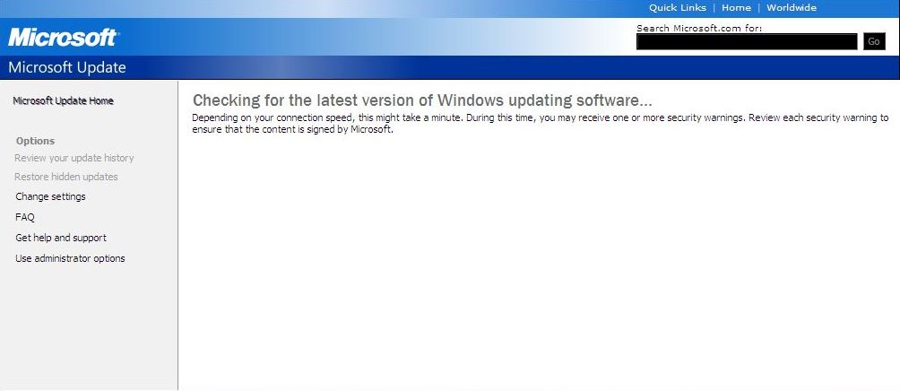

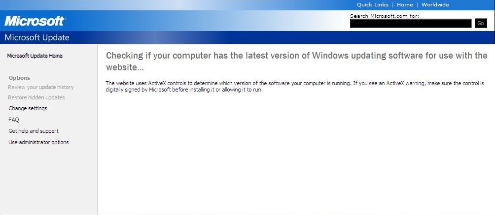

Elliot77 Posted December 27, 2014 Author Posted December 27, 2014 Thanks everyone. I enabled Auto Update and BITS and tried MS online windows update. The site updated my computer to something like the current installer, then the site got stuck in a loop alternating between two readouts:
Ponch Posted December 27, 2014 Posted December 27, 2014 Do you have a possbility to enable the ActiveX thingy at the 1st screenshot? Like a yellow line up your screen?

Elliot77 Posted December 28, 2014 Author Posted December 28, 2014 Do you have a possbility to enable the ActiveX thingy at the 1st screenshot? Like a yellow line up your screen? No I don't Please do locate inside C:\WINDOWS\SYSTEM32 and report the versions of the following files:muweb.dllwuweb.dllLegitCheckControl.DLL wuweb.dll - 7.0.6000.374muweb.dll file is missing (checked hidden as well)LegitCheckControl.DLL - 1.9.40.0
dencorso Posted December 28, 2014 Posted December 28, 2014 I see... So, then, download from the links I'm giving here and install the following updates: WindowsXP-KB892130-ENU-x86.exe - Windows Genuine Advantage Validation v1.9.42.0 (KB892130); WindowsXP-KB898461-x86-ENU.exe - Permanent copy of the Package Installer for Windows (KB898461); WindowsXP-KB942288-v3-x86.exe - Windows Installer 4.5 (KB942288). IIRR, each may require a reboot. After both reboots, try again Windows Updates, and lets see what happens... (I guess some more things will be needed, but let's go one step at a time, OK?).
Elliot77 Posted December 28, 2014 Author Posted December 28, 2014 Packages successfully installed. No reboots required, but I did one anyway. Win Update is still getting stuck in the loop I referenced previously.
dencorso Posted December 28, 2014 Posted December 28, 2014 OK. Now let's install: The last official MS IE8 Cumulative Update (KB2936068), and the last official out-of-band update for IE8 (KB2964358), too. After the needed reboots, try again windows update, from the Tools menu in IE8.
Elliot77 Posted December 28, 2014 Author Posted December 28, 2014 Completed, but no dice (same loop as mentioned). Probably a dumb question, but could this have anything to do with my having implemented the IE8 fix for the serious security vulnerability discovered after XP support ended?
dencorso Posted December 28, 2014 Posted December 28, 2014 Which fix? The one you mention is fixed by KB2964358 you've just installed. In any case, go to the Control Panel, Security Center, and turn off Automatic Updates, if you hadn't already done it. We want the site to work manually so that you can hide the two nagging updates before anything, when it starts working at last. The nagging updates are, of course, KB293427 (the XP EoS nag) and KB905474 (the WGA Notifications nagger, unneeded, not to be confused with KB892130, the WGA Validation, which is fundamental for the functioning of the system and we just updated some posts above). Then grab this update but do not install it: WindowsUpdateAgent-7.6-x86... instead of installing, open it with 7zip and extract from inside it a file named WUA-Downlevel.exe and put it into a temporary folder created just for this. Open a DOS box inthat folder, and then run the following command: WUA-Downlevel /wuforce <enter> Afterwards reboot and remove the temporary folder. Then go to windows update, and report what happens, please.

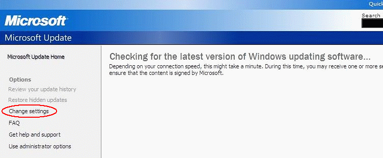

dencorso Posted December 28, 2014 Posted December 28, 2014 Unless the contents of my previous post were enough to solve your issue (which I doubt), here's what's next: Open IE8, click again on the "Windows Update" option in the "Tools" menu. After the page loads, click on "Change Settings" on the Microsoft Update page (circled in red on the attached pic) to disable Microsoft Update and revert to Windows Update. Do it. And if Windows Update starts to work, select "Custom", then let it create the available updates list, then hide those two I mentioned above. Close IE8, reopen it and go again to Windows Update, select "Custom", then let it create the available updates list, and confirm the hidden updates remain hidden. Close IE8, reopen it and go again to Windows Update and accept the invitation to upgrade to Microsoft Update, select "Custom", then let it create the available updates list, and confirm once again the hidden updates remain hidden and, if so, apply the high priority updates. In any case, please, do let us know how it went.
Elliot77 Posted December 28, 2014 Author Posted December 28, 2014 Which fix? The one you mention is fixed by KB2964358 you've just installed.In any case, go to the Control Panel, Security Center, and turn off Automatic Updates, if you hadn't already done it. We want the site to work manually so that you can hide the two nagging updates before anything, when it starts working at last. The nagging updates are, of course, KB293427 (the XP EoS nag) and KB905474 (the WGA Notifications nagger, unneeded, not to be confused with KB892130, the WGA Validation, which is fundamental for the functioning of the system and we just updated some posts above).Then grab this update but do not install it: WindowsUpdateAgent-7.6-x86... instead of installing, open it with 7zip and extract from inside it a file named WUA-Downlevel.exe and put it into a temporary folder created just for this. Open a DOS box inthat folder, and then run the following command:WUA-Downlevel /wuforce <enter>Afterwards reboot and remove the temporary folder. Then go to windows update, and report what happens, please.I had unregistered vgx.dll (but have now re-registered it).I extracted WUA-Downlevel.exe to a temp folder, navigated to that folder in dos, then ran the command. I received an "extraction failed - the directory or file cannot be created." message (I realize I may have made a beginner's error somewhere here).
