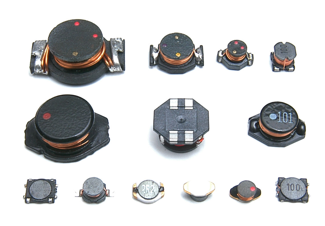

jaclaz Posted December 30, 2014 Posted December 30, 2014 Well, still a stupid PUIS command issued by the stupid driver in the stupid Windows 10:http://en.wikipedia.org/wiki/Power-up_in_standby cannot be responsible for: Yes both are dead the PCB boards fried. One has a popped capacitor or something. It's a short height round thing and the a piece of the plastic broke off and you can see the copper wires forming loops inside. jaclaz
Guest Posted December 30, 2014 Posted December 30, 2014 That was my original diagonals but I was wrong. The black things which I am referring to as capacitors are really not an issue. It's more of a cosmetic thing according to the data recovery firm. Though you can see the copper wire winding around inside they have zero effect on their functions. He told me he sees it a lot. My guess is that the plastic is very brittle and during shipping it might have had some rough handling. The real problem was that the drives had been put to sleep and got stuck there. He just needed to run their $10,000 PC3000 tool on it to disable the PUIS function. You can do the same with a simple free utility that's shown in the few articles I've read on how to fix this hard drive state.
dencorso Posted December 30, 2014 Posted December 30, 2014 Well, all in all, I'm glad you've recovered all your stuff, and that both disks turned out to be OK. The round thingies having cooper wire wound inside must be inductors, which insulation became brittle due to the heat (a HDD is something really tropical, working at about 44 °C) and crackled, the shed pieces on being removed/manipulated. And, please, do yourself a favor, fork some more money and get yourself a 2 TB WD MyPassport. They do rock, and don't cost too much. And, then, do create, at least, one monthly backup to an external, removable HDD. The MyPassport is USB 3.0, you almost won't notice it's an external HDD at all. And if a PCI-e card is needed to complete the package, be sure to buy something base on a Renesas chip, they're the way to go.
Guest Posted December 31, 2014 Posted December 31, 2014 (edited) Thanks. Huge relief. This has sent me into a state of hysterical paranoia. I've backed up my D drive that contains my portable programs, my profile folder, desktop, and so on to Google Drive and will be doing that regularly since it fits in the space Google gives you. It's only about 10 GB's but it's very important how I have things setup on D. The rest, I'm going to have to have major redundancies. This can never, ever happen again. I might load one hard drive with my stuff and drop it off at a relative house in case of fire or theft. I have an insane amount of high definition video content. Not a lot of music or pictures really. Those, I don't care too much about. And yes, you are right. They are inductors. I google for images of them and that's what the inside of the blank circular things look like. Edited December 31, 2014 by -X-
