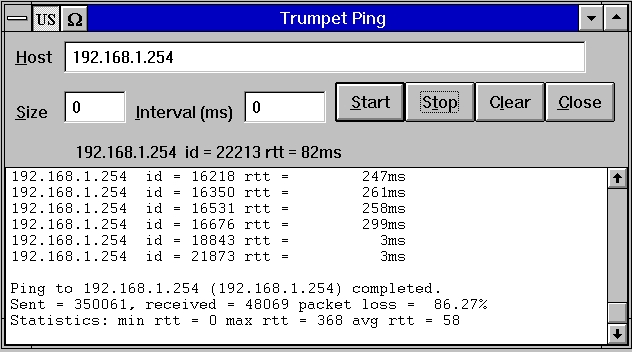

awkduck Posted January 20, 2023 Posted January 20, 2023 As a test, before loading into Windows, you could use mTCP Ping. If that works, you could load into Windows, not start Trumpet, and then run mTCP Ping; in a MsDos Prompt. If that works, load Trumpet and use it's Ping. If they all work, check the D.N.S..

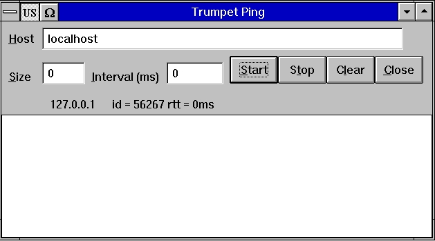

awkduck Posted January 20, 2023 Posted January 20, 2023 Yes, you put an I.P., that is on your network, in place of "localhost". Click Start, wait a few seconds, and then click Stop.

awkduck Posted January 20, 2023 Posted January 20, 2023 (edited) You are having fun with this 192.168.1.68 (show above as 168.192.1.68) was your I.P. right? 127.0.0.1 > <192.168.1.68 = localhost We want to ping an I.P. that is outside your Virtualbox machine. The gateway, you posted earlier, is 192.168.1.254. You should ping that. If your network allows pings between clients, you could also ping another computer on your network. This is how you would use mTCP ping "C:\MTCP\ping 192.168.1.254". Edited January 20, 2023 by awkduck
awkduck Posted January 20, 2023 Posted January 20, 2023 Congratulations, you have network connectivity! So the issue would seem to be your D.N.S. settings in Trumpet Setup. On your host PC, go to Who is my DNS and look for the result under "DNS Server". Put that in Trumpet's setup up for DNS. For USB, you might check out this page.

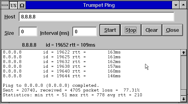

shelby Posted January 20, 2023 Posted January 20, 2023 i change it and nothing happens even if i put the google dns
awkduck Posted January 20, 2023 Posted January 20, 2023 (edited) Does it let you ping the google DNS? What is you current Virtualbox network config? If you run DHCP from Dos, Dos it still assign the same I.P.? Maybe I.P.s have changed on your network. Edited January 20, 2023 by awkduck
shelby Posted January 20, 2023 Posted January 20, 2023 I am not run DHCP at all. I have bridged card in virtualbox. The google dns is the one i use in my network

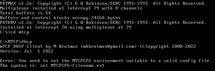

awkduck Posted January 20, 2023 Posted January 20, 2023 (edited) Try Virtualbox NAT. You could also just run DHCP in a MsDos Prompt, after PKTDRV. The only reason for doing so, is to see what I.P. it assigns you. DO NOT add it to autoexec.bat. You really don't need it, for your system's normal use. It is more like a test/demo application. Other mTCP programs have DHCP built in. They all use the same mTCP config file. Edited January 21, 2023 by awkduck

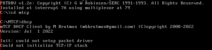

shelby Posted January 21, 2023 Posted January 21, 2023 nothing changes with Virtualbox NAT. Even this
awkduck Posted January 21, 2023 Posted January 21, 2023 Good, we want all of those things to work. It is okay to set the mTCP config "SET MTCPCFG=C:\MTCP\CONFIG.CFG" in autoexec.bat. It is for all mTCP programs. It won't hurt anything. We just don't need DHCP in autoexec.bat. So with MTCPCFG set, reboot and manually run DHCP. We want to see what I.P. it assigns you. This is to make sure the I.P. we later put in Trumpet, is "unused" on the network. It may be different than before. DHCP should display the settings it receives. But it will also be saved at the bottom of" C:\MTCP\CONFIG.CFG". Next, Just to be extra careful, reboot and load into windows; without running DHCP. In Windows, put the new I.P. in Trumpet setup; unless it is the same. Test Opera. If Opera does not work, open a MsDos Prompt, run PKTDRV, and then run Links. Once Links is up, press the "G" key and type google.com. If Links works, but Opera does not, then we know it is either the settings in Trumpet or something is wrong with Opera. You could try to install Netscape as a test. If you can still Ping the D.N.S. with Trumpet Ping, then it almost sounds like a problem with Opera's settings. But I have to say, if you didn't change any of Opera's settings, the default settings should work.
