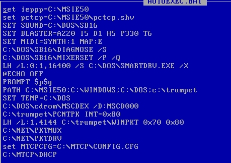

awkduck Posted January 19, 2023 Posted January 19, 2023 You could try CuteMouse. I myself, out of curiosity, would like to see your whole autoexec.bat and what happens when you run Trumpet. But only if you feel like obliging me this. I will not be offended, if you wish only to stay on your current task.

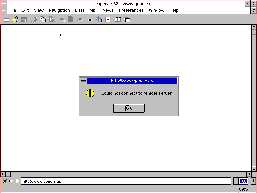

shelby Posted January 19, 2023 Posted January 19, 2023 This is from windows nt3.1. In windows 3.11 there is no internet with ip.....
awkduck Posted January 20, 2023 Posted January 20, 2023 To run Cutemouse, run ctmouse.exe. shelby, I've noticed that your packet driver isn't in autoexec.bat. There is nothing for PKTMUX to use, without a packet driver. If I get a chance, I will post the description of a working setup.

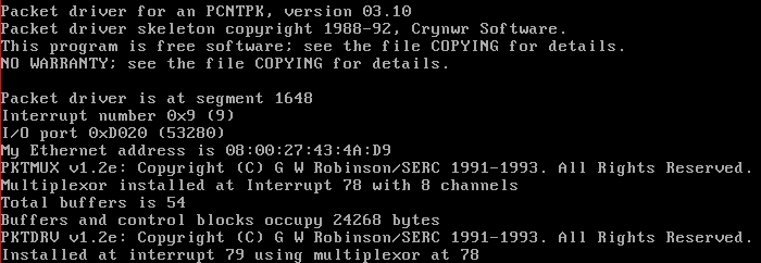

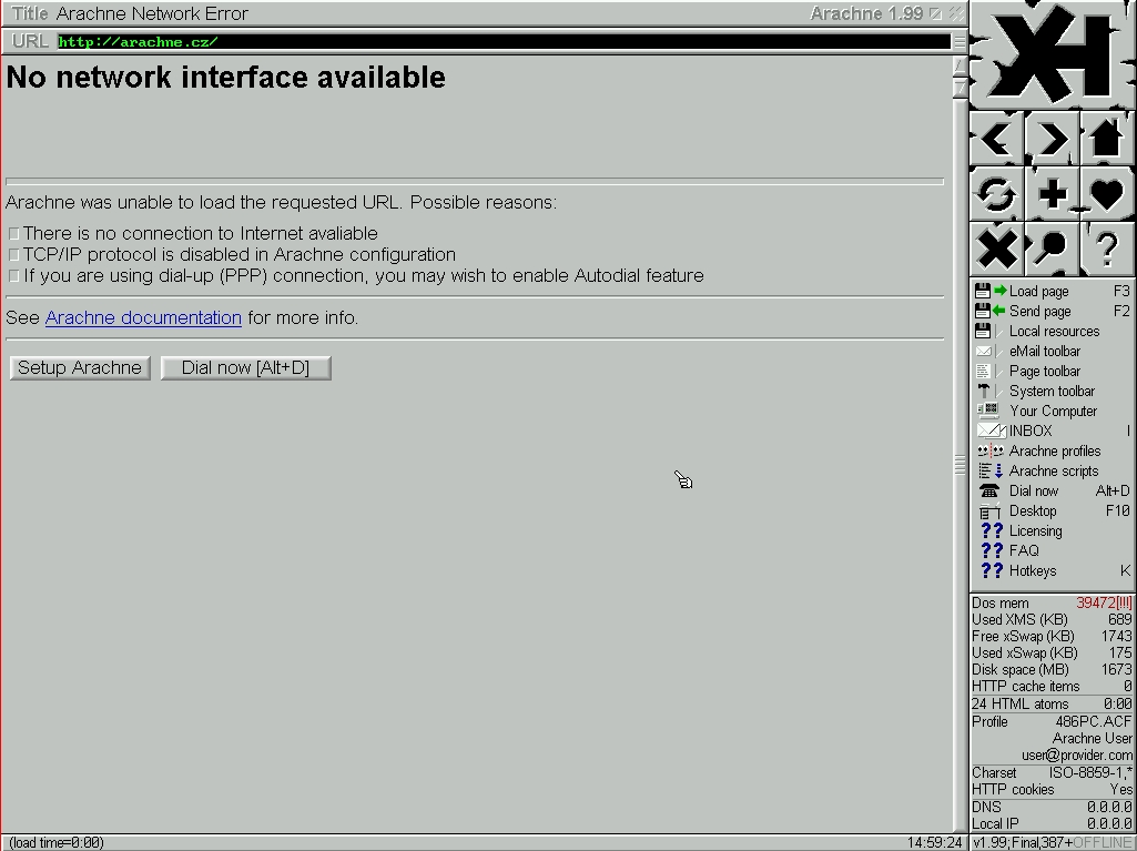

shelby Posted January 20, 2023 Posted January 20, 2023 (edited) this gives me this Edited January 20, 2023 by shelby

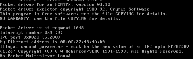

shelby Posted January 20, 2023 Posted January 20, 2023 (edited) I see that the final interrupt number must be < 80 Edited January 20, 2023 by shelby

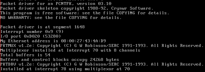

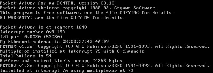

shelby Posted January 20, 2023 Posted January 20, 2023 (edited) this gives me this and this and this Edited January 20, 2023 by shelby
awkduck Posted January 20, 2023 Posted January 20, 2023 (edited) Yeah, I forgot. The range is 0x60 to 0x7F. Your last setup looks good. I tested it last night. I would use the Trumpet Ping program, to ping your gateway. I guess I've had a packet driver that could only go to 0x74. So not all things are equal. Edited January 20, 2023 by awkduck
