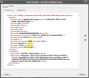

No, I'm not. And here's your proof:
post-386995-0-39410500-1398855906_thumb.
PID of system level (nagware delivery mechanism
post-386995-0-22336400-1398855911_thumb.
Process Explorer correlating PID to csrss.exe
I can't imagine that you might try to say that the role of csrss.exe, a process critical to system operation which "terminating will result in system failure", is being hijacked here in some other way than I described, but since there's lots of time until I wake up I'm sure you'll think of something to pick at. Whatever that is, keep in mind that the as more is posted the picture only gets clearer and I will come back to refute every single point where you said I was wrong until it's clear you're full of it.
I resent having to make a picture book with links for you. But it seems that's the only way you will admit it's not that I "saw something somewhere" and "don't understand it" while you don't know anything about it "because neither one of these happens in your tools". Except the ones that disappeared from the list without explanation of course.
Let me know when you've seen enough to give up the pretense completely, instead of just one or 2 points at a time, so I can stop wasting my time. I hope it will lead to a fix, but still there is not even an indication of that.

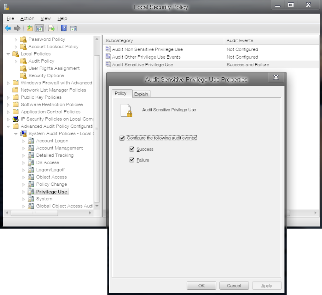

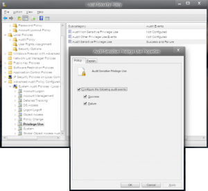

Before that, though, I think it's important to let people see some of those things happening on their own machines. Rather than picking at 1 thing and then another, this should give a good look into some of the more egregious security holes created by restructuring system wide security. And that's all I will do, no explanation and no assumption. I'm sure there's a very good explanation
1. Setting up Auditing for "sensitive privilege use" (Windows term, not mine)
post-386995-0-03256900-1398856631_thumb.
[ 500k limit per post, continuing in the next post... ]

Still here. Sorry. slept for 30-45 min apparently. I will finish this post, and then have to come back. It's pretty clear even just from the screenshots...
Let's just look at the biggest thing right now, as mentioned before that's that's lsass.exe, the authority for all security on your computer. What should definitely not be happening, and only happens when DWMGlass is running, is trying to pull Tcb privilege constantly as a regular user.
Out of disk space for screenshots. Great. External host. Looks giant so if its the same on your end, sorry about that. Somehow doubting I'll get more space to provide the screenshots I'm obligated to....
Anyway, Tcb means "Acting as Part of the Operating system":
DWMGlass disabled = no sensitive privilege requests denied, because everything it's asking to do is within the scope of what it's supposed to be doing and the OS lets it through without issue
DWN Glass disabled = already described but will go over with screen in a second with screens. Basically, Tcb in user land... the OS obviously does not belong in the LUA context so that will be how it wraps up and leave the door open for counterpoint and explanation. Maybe
So I will brb with that and in the meantime ,as I said I would not judge or jump to conclusions, the door is wide open Mr. Big, would love to hear your take on this behavior you're entirely unaware of

I am getting there... the pots I just made should explain somewhat but probably not enough. LUA is Limited User Account and having the security process asking for system access from that account is a behavior that should never happen, since it's the master after all. Except when its compromised... but I am trying to not say anything too inflammatory because we saw the reaction earlier and I want to give all the information first, since the explanations are all online also. But I will cover everything eventually, or at least I intend to. Sorry for not being more thorough. It is 10 am and I havent slept yet as you can see the posts have gone back quite a while
To your point on the purpose of public forums, agreed. Consider though, if I just PM it, do you think it will get fixed? Maybe? That's why it's posted here, for visibility. It may not make sense yet, as i haven't covered it in detail and that will take some time. But it certainly should have been making sense for quite a while to the target audience. I don't see any more name calling coming my way, which is a nice thing. Just saying.
