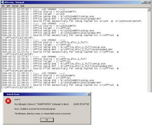

there you go, I tried it a few times and none of the vareations work, if its failing at line 0 then that means that its not starting one of the parts. i think there maybe a problem with it starting the unattended file, no the msi file. But then again, I know bugger all. I tried a setup.exe thats on the cd, (admin point doesn't have one) and it did the same thing
office.log

@ghost: When you run an unattended install of office what is your command?
That is where the problem is. Send it to me and ill see what i have differently in the code.

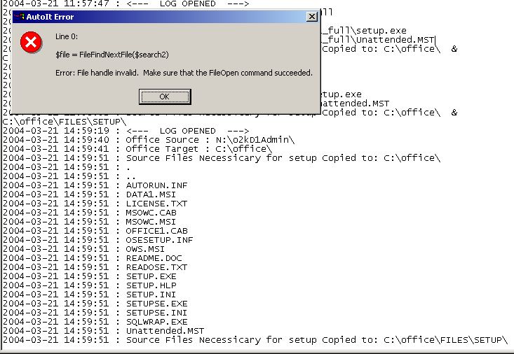

I finally got around to slipstreaming SP3 into my Office 2000 Sr1 administrative point folder (o2kD1Admin). :) and for giggles I patched my o2k Sr-1 folder with sp3 (office_disc_1_full) I then created a MST using the data1.msi file from the o2kD1Admin folder. once done I ran your program and no matter which folder i specify for the files or if i click yes or no at the "continue installation after shrinking" promt it spits out an error message. attached (hopefully *cross fingers*) is my log and jpg of the error. hopefully you can make sense of it =-/
***on a side not I just realize this thread was about office 2003 (go me) but anywho shouldn't it still work with o2k?
thanks for your time
  • Author
@FlyorDIE: well kindof... i have never tested on o2k. the problem it that the setup should have atleast started that has nothing to do with the different versions.
I am trying to figure out where im going wrong with the startup code. i am in the process of rewriting the file selection portion of this. So when i get that finished i will just release that part to se if i fixed the problem. :)
As far as O2k goes... hey you are more than welcome to test it and maybe ill be able to make it work for it too. so if you want to bear through it ill see what i can do. :/
