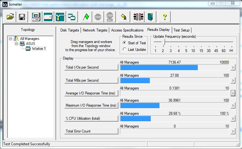

pointertovoid Posted June 18, 2012 Posted June 18, 2012 (edited) Which role (if any) would NCQ (Native Command Queuing) have in the benchmark(s)?NCQ makes a huge difference in real life. When booting W2k (whose disk access isn't as optimized as by Xp with its prefetch) it means for instance 18s instead of 30s, so Ahci should always be used, even if it requires an F6 diskette.Different disks have different Ncq firmware resulting in seriously different experienced performance, and this cannot be told in advance from the disks' datasheet, nor from benchmarks of access time and contiguous throughput. Anyway, the arm positioning time between near tracks should be more important than random access over the whole disks, which usage never requires.Few benchmarks make a sensible measurement here. Ncq is meaningful only if a request queue is used, but for instance Atto isn't very relevant here; it seems to request nearly-contiguous accesses, which give unrealistic high performance and show little difference between Ncq strategies; nice tool however to observe quickly if a volume is aligned on a Flash medium. The reference here is IOMeter but it's not easy to use, especially for access alignment. Recent CrystalDiskMark tests with Q=32 which is far too much for a workstation (Q=2 to 4).Example of IOMeter with Q=1, versus Q=4 of one 600GB Velociraptor, versus Q=4 of four VRaptors in aligned Raid-0, on random 4k reads over 100MB (but 500MB for the Raid) (an SSD would smash N* 10k IO/s in this test):(log in to see the image, click to magnify)As a practical consequence, an Ssd should be chosen based on few available tests available only from users... IOMeter, if not then CrystalDiskMark which at least tells the random delay for small writes, or good as well: "practical" comparisons at copying or writing many files. On the disks I own, I check the "find" time of some file names among ~100.000 Pdf in many subdirectories, the write time of many tiny files... Edited June 18, 2012 by pointertovoid
jaclaz Posted June 19, 2012 Posted June 19, 2012 Which role (if any) would NCQ (Native Command Queuing) have in the benchmark(s)?NCQ makes a huge difference in real life. When booting W2k (whose disk access isn't as optimized as by Xp with its prefetch) it means for instance 18s instead of 30s, so Ahci should always be used, even if it requires an F6 diskette.Different disks have different Ncq firmware resulting in seriously different experienced performance, and this cannot be told in advance from the disks' datasheet, nor from benchmarks of access time and contiguous throughput. Anyway, the arm positioning time between near tracks should be more important than random access over the whole disks, which usage never requires.Few benchmarks make a sensible measurement here. Ncq is meaningful only if a request queue is used, but for instance Atto isn't very relevant here; it seems to request nearly-contiguous accesses, which give unrealistic high performance and show little difference between Ncq strategies; nice tool however to observe quickly if a volume is aligned on a Flash medium. The reference here is IOMeter but it's not easy to use, especially for access alignment. Recent CrystalDiskMark tests with Q=32 which is far too much for a workstation (Q=2 to 4).Really? Guess why I had previously posted this? The whole point is that benchmarks are - generally speaking - benchmarks and they are ONLY useful to compare different settings (or different OS or different hardware), BUT the results need to be verified.In no way thy are (or can be) representative of "real usage".In other terms, it is perfectly possible that the result of a benchmark (which is an "absract" set of copying data with a given method) seem "almost the same" but on real usage a BIG difference is actually "felt", or viceversa, it is perfectly possible that in a benchmark a given setting produces an astoundingly "better" result, but then when the setting is applied in "real life" no (or very little difference) is "felt".and why I asked the qiestion in the form: Which role (if any) would NCQ (Native Command Queuing) have in the benchmark(s)? jaclaz
DiracDeBroglie Posted June 19, 2012 Author Posted June 19, 2012 (edited) NCQ makes a huge difference in real life. When booting W2k (whose disk access isn't as optimized as by Xp with its prefetch) it means for instance 18s instead of 30s, so Ahci should always be used, even if it requires an F6 diskette.Different disks have different Ncq firmware resulting in seriously different experienced performance, and this cannot be told in advance from the disks' datasheet, nor from benchmarks of access time and contiguous throughput. Anyway, the arm positioning time between near tracks should be more important than random access over the whole disks, which usage never requires.Few benchmarks make a sensible measurement here. Ncq is meaningful only if a request queue is used, but for instance Atto isn't very relevant here; it seems to request nearly-contiguous accesses, which give unrealistic high performance and show little difference between Ncq strategies; nice tool however to observe quickly if a volume is aligned on a Flash medium. The reference here is IOMeter but it's not easy to use, especially for access alignment. Recent CrystalDiskMark tests with Q=32 which is far too much for a workstation (Q=2 to 4).Example of IOMeter with Q=1, versus Q=4 of one 600GB Velociraptor, versus Q=4 of four VRaptors in aligned Raid-0, on random 4k reads over 100MB (but 500MB for the Raid) (an SSD would smash N* 10k IO/s in this test):What is a F6 diskette?>>The reference here is IOMeter but it's not easy to use, especially for access alignment.What is access alignment?-----------------------------------I did the IOmeter test too on my 1TB Seagate Barracuda 7200.12 system HDD, with 3 different options in the pane |Disk Targets| -> |# of Oustanding I/O|=1, then =4 and again =32; I suppose that must be the Queue Depth equivalent to (or equal to) the NCQ in the HDD (correct me if I'm wrong). I'm not all to sure how to interpret the options |Maximum Disk Size (in sectors)| and |Starting Disk Sector|; do these need a figure?? I left them at zero during my tests.In the pane |Access Specifications| I've put the value |4K; 100%Read; 0%Random|. The results from the tests are showns in the screenshots hereafter for #I/O=1, =4 and =32.IOmeterQD1; IOmeterQD4; IOmeterQD32The difference in performance between #I/O=1 and =4 seems significant; the difference between #I/O=4 and =32 is less, but still noticable. Anyhow, with #I/O=32 the performance comes pretty close to what I had earlier with ATTO Disk Benchmark.I also performed a test with #I/O=64 (no screenshot); the performance was better than with #I/O=1, but poorer than with #I/O=4. It looks like offering too many (>32) parallel I/Os chokes the NCQ handling in the HDDs controller.Still a question about the |Access Specifications| pane where I've put |4K; 100%Read; 0%Random|. All possible options were with 0% Random. I'm not sure what is meant with "Random"; does it mean random sector location of the HDDs platters? If yes, then 0% Random should mean 100% non-Random, right? If yes, 100% non-Random should mean 100% sequential (contiguous), which basically puts us into the same context of ATTO. But if both IOmeter and ATTO perform nearly-contiguous measurements, why does |# of Oustanding I/O| in IOmeter impacts the performance so much, while the Queue Depth in ATTO does not nearly influences the performance? Sticking point is how to interpret "Random" in |4K; 100%Read; 0%Random| for IOmeter?johanPS: I couldn't figure out how to introduce the image file inline in the text; they are now attached at the back. Edited June 19, 2012 by DiracDeBroglie
