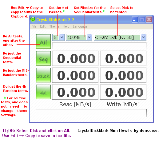

dencorso Posted February 26, 2012 Posted February 26, 2012 One was listed to work with Windows 98 but I can't seem to get any good readings, no help in the "Help Tab". That program was CrystalDiskMark v2.2.0o (Win 9x).

dencorso Posted February 26, 2012 Posted February 26, 2012 One was listed to work with Windows 98 but I can't seem to get any good readings, no help in the "Help Tab". That program was CrystalDiskMark v2.2.0o (Win 9x).Why not use the single program that is known to work?
Monroe Posted February 26, 2012 Author Posted February 26, 2012 Well, I am not interested in doing any USB flash drive testing on any file. I just want to transfer files and maybe get a quick flash speed reading every so often. There was no Help (to me anyway) that came with the program and I have "no clue" as how to work with it or "understand" any information the program is giving me. I looked at the figures and wasn't sure what I was actually seeing. I appreciate that you posted the CrystalDiskMark image but I still don't understand what I'm looking at ... as I said earlier I am not interested in running USB Flash Drive tests. OK, ... let's say this is what I want to do. ... here are three examples of me wanting to transfer a 700 MB file from C drive to drive E .First flash drive will be a 4 GB drive, the second flash drive will be an 8 GB drive and the third flash drive will be a 16 GB drive. .... As I said ... I do not want to DO any USB tests ... this is the "real thing" ... transferring one 700 MB file to each USB drive. What settings should be set ? .... would the settings for all three drives be the same? This is over my head as I look at that image ... I guess I would set the 5 to 1 pass, one file, one time transfer. I just want to transfer a file and see some "speed figures" and not fool with any tests. I don't always pick up on things posted here, I feel most people at this forum are "light years" ahead of me with computer knowledge and all the inside workings ... but I still learn something new once in awhile.So you are saying I can use CrystalDiskMark to bypass all those "test tabs" and get my file transfered and get a quick no-nonsense speed reading and move onto another file? I do appreciate your assistance and from everyone else also, but I don't think this is the program I was hoping to find, but I could be wrong. I will work with it again later tonight or tomorrow....
dencorso Posted February 27, 2012 Posted February 27, 2012 Set the test size to 700 MB, let the # of passes remain 5 and click on Seq, instead of All. CrystalDiskMark will tell you the speed (in MB/s) for read and write operations, selecting the best result out of 5 tries. It's simple like that.Now, what does it actually mean? Let's see (my tests were performed with a 100 MB file, not a 700MB one) how long it takes to copy a 100 MB file, here are some real life data:Sony Micro Vault 1GB (made in 2005):Sequential Read : 10.245 MB/s --> or (100 / 10.245) = 9.76 sSequential Write : 6.198 MB/s --> or (100 / 6.198) = 16.13 s Kingston DataTraveler DT100 8GBSequential Read : 23.211 MB/s --> or (100 / 23.211) = 4.31 sSequential Write : 15.256 MB/s --> or (100 / 15.256) = 6.55 sOCZ ATV Turbo 8GBSequential Read : 32.630 MB/s --> or (100 / 32.630) = 3.06 sSequential Write : 26.449 MB/s --> or (100 / 26.449) = 3.78 s Corsair GTR 64GBSequential Read : 28.587 MB/s --> or (100 / 28.587) = 3.49 sSequential Write : 16.655 MB/s --> or (100 / 16.655) = 6.00 sPatriot Supersonic Magnum 64GB (in USB 2.0 mode)Sequential Read : 30.611 MB/s --> or (100 / 30.611) = 3.27 sSequential Write : 27.303 MB/s --> or (100 / 27.303) = 3.66 sSo, my good old Sony Micro Vault 1GB (which was razor-edge technology in 2005) takes 9.76 seconds to finish when I read 100 MB from it, while the OCZ ATV Turbo 8 GB finishes the same operation in 3.06 seconds (or in about one third of the time). And the same Sony Micro Vault 1GB takes 16.13 seconds to finish when I write 100 MB to it, while the Patriot Supersonic Magnum 64GB finishes the same operation in 3.66 seconds (or in about one fourth of the time). Moreover the Sony Micro Vault 1GB takes 9.76 seconds to finish when I read 100 MB from it, but takes 16.13 seconds to finish when I write 100 MB to it, so the write operation is about twice as long as the read operation. All this was measured with the same motherboard (Asus A7V600-x), and the same processor (Athlon XP 3000+ overclocked to run as a 3400+) and the same OS (Win XP SP3). See this results from a much l faster (SATA I) hardware ramdrive:GB i-RAM 1.5GiB under Win 98SESequential Read : 122.069 MB/s --> or (100 / 122.069) = 0.82 sSequential Write : 120.388 MB/s --> or (100 / 120.388) = 0.83 sGB i-RAM 1.5GiB under Win XP SP3Sequential Read : 132.878 MB/s --> or (100 / 132.878) = 0.75 sSequential Write : 120.388 MB/s --> or (100 / 120.388) = 0.79 sXPSP3 is 9% faster for reads and 5% faster for writes than 98SE, both fully tweaked, for the same hardware and processor. Hence, write times are always greater than read times. Different OSes give slightly different results, with new OSes being faster. Different hardware gives different results, with newer hardware being faster, in general. What you did in your real-life example is, by far, the most unfair comparison, since you wrote (slower than reading) to your unnamed pendrive in the older hardware (slower) with the older OS (slower), getting the longest write time possible. Then you read it (faster) in the newer hardware (faster) under the newer OS (faster), and got the shortest read time possible for the same pendrive. As I said many posts ago, you've got an absolutely normal result.Moreover, the empirical (not theoretical) limit for sustained USB 2.0 transfers is about 35 MB/s (and I know no pendrive that really reaches it, especially for write operations), so, even if you acquired the bestest pendrive ever under the fastest hardware, CPU and OS possible, you wouldn't be able to do any 700 MB transfers significantly below 20 seconds, no matter what you do.
