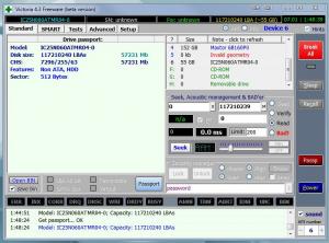

cableghost Posted January 7, 2012 Author Posted January 7, 2012 Test the drive with Victoria for DOS. It will show right away the power issue and if its locked. You can also unlock it that way by following Help.Thanks for the recommendation, but unsure what I should be looking for. Attached is a screenshot of it.attachment=33748:victoria_screenshot.jpg]

jaclaz Posted January 8, 2012 Posted January 8, 2012 Test the drive with Victoria for DOS. It will show right away the power issue and if its locked. You can also unlock it that way by following Help.Thanks for the recommendation, but unsure what I should be looking for. Attached is a screenshot of it.Just for the record what zamarac suggested was Victoria for DOS.What you got is Victoria for Windows.With the former you need to attach the drive DIRECTLY (no USB adapter in between) to the IDE/PATA bus.With the second you can use a KNOWN TO BE FUNCTIONAL USB converter, BUT the amount of "access" you will have to the drive is limited when compared to directly attaching it.A (rather skimpy) help file for Victoria for Windows is here:http://forum.hddguru.com/victoria-for-windows-detailed-english-manual-release-t6902.htmljaclaz
