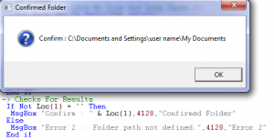

gunsmokingman Posted November 7, 2011 Posted November 7, 2011 @gunsmokingman Thanks for the alternative. Although your script looks for "Cabfolder1", it returns the value of Cabfolder2. Suppose I add an extra line to folderstore.ini to test for empty string/path, and I specify "Cabfolder2" within the script, it return Cabfolder3 value. Or do I miss out something? Normally the expected output is the string on the right only. The script rtn the whole line, including strings on the left.My bad here is a Script that will do what you want.Contents of the folderstore.ini I used[Directory]Cabfolder1=C:\Documents and Settings\user name\My DocumentsCabfolder2=C:\Documents_and_Settings\user_name\My_DocumentsSave As Read_Ini_2.vbs'-> Object For Runtime Dim Fso :Set Fso = CreateObject("Scripting.FileSystemObject")'-> File To Open, Place Full Path If Script Not Is Ame Folder as Ini Dim Ini :Ini = "folderstore.ini"'-> Varibles For Run Time Dim Chk, Loc, Obj, Ts'-> Check For File Exists If Fso.FileExists(Ini) Then'-> Open And Read All Into One Varible Set Ts = Fso.OpenTextFile(Ini,1) Chk = Ts.ReadAll Ts.Close'-> Split The Varible By Line And Loop Threw It For Each Obj In Split(Chk,vbCrLf)'-> Filfter Out Cabfolder1 If InStr(1,Obj,"Cabfolder1",1) Then'-> Split The Line Into Separate Objects Loc = Split(Obj,"=") End If Next Else'-> File Not Found MsgBox "Error 1 Missing : " & Ini WScript.Quit(0) End If'-> Checks For Results If Not Loc(1) = "" Then MsgBox "Confirm : " & Loc(1),4128,"Confirmed Folder" Else MsgBox "Error 2 : Folder path not defined.",4128,"Error 2" End ifRename Read_Ini_2.vbs.txt to Read_Ini_2.vbs to make activeRead_Ini_2.vbs.txt
Geej Posted November 7, 2011 Author Posted November 7, 2011 @jaclazInstead of finding the actual string of cabfolder1, you inverted it via Find /V. Hence result returns the cabfolder1.Nice trick.@gunsmokingmanWorks fine now. Thanks for the fix.
