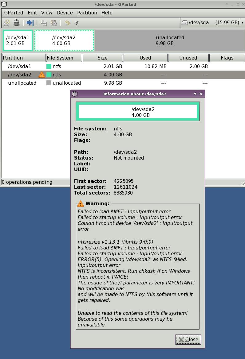

JedClampett Posted September 12, 2011 Author Posted September 12, 2011 (edited) Thanks jaclaz.I did format the 16GB Flash drive with an 8GB FAT32 partition, which appeared to work OK, as I installed Vista SP1 & SP2, and other 32 bit Apps from that onto a Vista laptop. I then tried to copy all the latest 7z DriverPacks archives from my downloads directory (ext3) to the FAT32 partition on the USB drive. I had some really weird looking files, with all sorts of strange control codes used for the filenames. The DriverPacks subdirectories were recursively copied. So I had an almost never ending set of subdirectories using the same name. In the end I just reset the partition table and started again.Basically all I want to do is copy Windows Apps and other things like DP's From my Centos ext3 partition, to the USB flash drive, so I can use them on Windows laptops.I'd go back to using FAT32 if I could copy the DriverPacks to the USB OK. Maybe I need to unpack the 7z archives first and copy those to the USB drive instead?Here is a screen shot of me trying to format the USB flash drive under Centos 5.6. The 2GB partition looks OK, but the 4GB produces those errors!I've just done another test under Centos 5.6 and this seems to be OK. I created an almost 8GB NTFS partition on some unused space on a fixed HDD. That works fine without any errors. Please see the attached screenshot. So it looks like the problem is with the removeable Flash drive? How is it that I managed to create a 2GB NTFS partition on the Flash drive, but I cannot create anything much larger that that? Edited September 12, 2011 by JedClampett
jaclaz Posted September 12, 2011 Posted September 12, 2011 I am not at all familiar with CentOS, but this could be a limitation of some kind in it's driver or a BIOS limit (IF CentOS somehow relies on BIOS info). If I were you, as said, I would install a filter driver in the Windows OS and do thinmgs as plain as possible.The driverspack issue sounds like having a different origin.Now that you have the 8 Gb partition on the HD can you try copying form the Ext3 partition to the NTFS one and then from the NTFS one to the USB stick?jaclaz

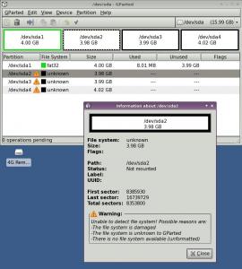

JedClampett Posted September 13, 2011 Author Posted September 13, 2011 Thanks for the reply jaclaz. I even installed Partition Master 9.0 Home Edition from EaseUS http://www.partition-tool.com/personal.htm onto a Vista Home Premium laptop.I went to format the 16GB? USB flash drive with Partition Master 9.0 and it said the operation completed successfully. However the 'Updating System' window hung, and the USB flash drive r/w light continued flashing. So I unplugged it after a while.The latest test was to delete the Partition Table, and try to create 4 x 4GB primary partitions. Here is what the screenshot looks like:Is there some way to discern the actual real size of a suspect Flash Drive?TIAJed

jaclaz Posted September 13, 2011 Posted September 13, 2011 I don't want to seem grumpier than I usually am , but you came here with a question, an answer was given to you and you use all available methods, programs and OS's on the earth BUT the ones that were suggested.Though unfortunately from what you posted you do seem like a victim of the scam, if you continue do "random" tests with apps/OS and methods I am not familiar with, it is difficult to make sure.FORGET ANYTHING you have done till now. You asked for a Win32 program, which should mean that you can somehow run a win32 OS.Get RMPREPUSB (already suggested you) and NOTHING else.http://sites.google.com/site/rmprepusb/Use it in a Win32 OS to partition/format AND test your USB sticks.Report what happens.jaclaz
