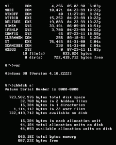

dencorso Posted July 24, 2011 Posted July 24, 2011 @RLoew: Are you implying that it wouldn't boot were it set as MS-DOS 4.1 boot disk, instead of a FreeDOS one?That sure would be an interesting finding. So I have a new test to perform, or have you tested it already? It was my understanding that the 36 MiB limit stemmed from the classic CHS BIOS 1024 cylinder limit when combine with The El Torito Standard (section 4.1, p. 14) 2 heads and 36 sectors-per-track, which I presumed the El Torito loader enforced for Media Type 3 booting... And, in any case, both heads and sectors-per-track are also set in the BPB, while the number of cylinders is not. Am I wrong, then?Seems I was right, after all: I converted the inner megafloppy (690 MiB !) image to MS-DOS 7.1, and it booted all right, just as before. reanimatolog rocks!

dencorso Posted July 26, 2011 Posted July 26, 2011 http://reboot.pro/14/page__pid__133740__st__30 Did I ever say you rock? Well, you do! Here's the progress we've made (version 2):1) The 36 MiB floppy image had to be created by hand, but that's done (by myself), and it's available for download.2) It was truncated. That's been solved by using DCopyNT (by Jorgen Bosman). 3) The image is empty (at least that's what the FATs say...) so it must be populated): VDM (by jaclaz) / VDK (by Ken Kato) solves that nicely. Moreover, it can also be mounted in True DOS, by using GRUB4DOS (and this is the only way to delete the Recycle Bin that is created once one deletes anything, while working on the image in Windows, by mounting with VDM/VDK).4) Furthermore, thanks to jaclaz's script, FAT12build.cmd, many other images can be created, as needed.5) The bootable ISO must be created. That's solved now by using The Free ISO Creator, but the Media Byte must be changed to 3. My little app cheltomb.exe helps changing and checking the Media Byte in a simple way.6) It may be needed to edit the .ISO, once its created... UltraISO does it right *iff* (iff = if and only if) one changes the media byte to 0 (no-emulation) before editing, and then, after all is done, changes it back to 3.7) I've used Nero 6.6 to burn the ISO onto a physical medium (a mini-CD RW, in my case)... but any burner can do it, so it's not a problem.
