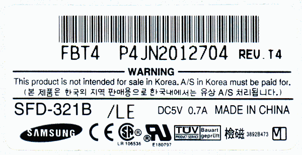

dencorso Posted August 4, 2011 Author Posted August 4, 2011 OK. But the table you provided is for 82 tracks. And almost all FDD made after 2000, including my quite unremarkable Samsung SFD-321B Rev. T4 (manufactured in Feb 2002), and the Mitsumi D359T7 I've just decommissioned, are capable of formatting/writing/reading 83 tracks reliably. This pushes up the max capacity on ED disks to ~4,150,000. Then I think 4.0 MiB as a round-number limit is a good number, after all. Can we agree on using it to define the frontier between floppy and superfloppy?
