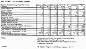

dencorso Posted January 24, 2012 Author Posted January 24, 2012 @jaclaz: I just found some minor mistakes in Known_floppies.xls: The 320k formats use 1 (not 2) sectors per FAT-12, and the 360K uses 2 (not 3) sectors per FAT-12.All FAT-12 formats above 180k and below 1.2 M use 2 sectors per cluster. The Table below is quoted from Thom Hogan's "The Programmer's PC Sourcebook", 1st. ed., Microsoft Press, 1988 (ISBN 1-55615-118-7) Section 2, p. 61.
jaclaz Posted January 25, 2012 Posted January 25, 2012 @jaclaz: I just found some minor mistakes in Known_floppies.xls: That's good, can you post a copy if the spreadsheet with the corrections (manually typing the correction replacing the formula and making the cell, say, RED background?The 320k formats use 1 (not 2) sectors per FAT-12, and the 360K uses 2 (not 3) sectors per FAT-12.I'll check . (and see what I can do with the formula)All FAT-12 formats above 180k and below 1.2 M use 2 sectors per cluster. Hmmm. jaclaz
dencorso Posted January 27, 2012 Author Posted January 27, 2012 Here's an interesting read: All Those Floppy Disk Formats… by Tim Paterson himself. And it's on-topic too, because it confirms 10 sectors per track is the absolute maximum for Double-Density floppies. There is a controverse point in it, however, because there Tim says that the 9-sector formats were already present in PC-DOS 1.1, which not only contradicts Undocumented DOS (as pointed out in the last comment there by os2museum) and the table by Thom Hogan I posted above, but is, in fact, a mistake, verifiable by simply running PC-DOS 1.1 format, which can only format 160 k and 320 k floppies. The 9-sector formats really were introduced with PC-DOS 2.0, and not before, although I do believe Tim's statement that they knew it was viable perhaps since PC-DOS 1.0 times.
