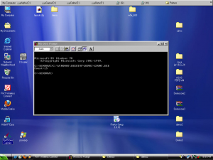

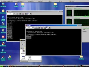

rloew Posted March 17, 2011 Posted March 17, 2011 Here is how is he doing nowThe Demo is working but it is not properly counting the Cores. I have attached another DEMOCORE.VXD and COUNT.EXE that will report the number of additional cores detected. Replace DEMOCORE.VXD and run COUNT.EXE. Let me know the result.Demo1.zip
RFMaster Posted March 17, 2011 Posted March 17, 2011 (edited) Done. Edited March 17, 2011 by RFMaster
