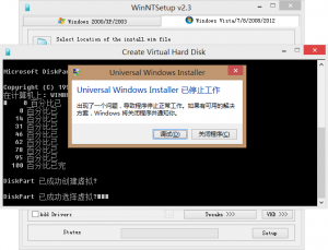

error occurs when creat VHD,win8 enterprise x64.
That's too much informations. ;)
The VHD creation is just a wrapper for windows' diskpart.exe.
Anyway there should be some error printed in the black window.
Also WinNTSetup should give back the error code and it's description.
Posted (edited)
Sorry,my OS is win8 enterprise x64 Chinese (Simplified).
when creat VHD ,this error pop-up.
post-362530-0-72491100-1348666130_thumb.
If I switch display language to english(I install english language pack just now for creating a bug report in english :D ), But creat VHD ok,no error. :o
so,the bug report is still in chinese. :wub:
Edited by adef
Posted (edited)
Thanks,
it seem this only occurs with some unicode languages. It's properly a bug in the text formating.
I'll download the 90 days win8 ZH-CN trail version and take a look at it.
Edited by JFX
Posted (edited)
hmm, strange either Chinese ANSI and OEM codepage can have different amount of characters or Stringlen() eats some :blink:
Please try v 2.3.0.2
Edited by JFX
2.3.0.2 works ok,thank you man :thumbup
