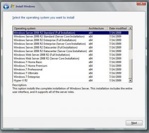

Here's a pic of my AIO ISO. It has every version of windows 7/ server 2008 r2. Only 3.91 gigs. When i get time im going to write a guide. Im thinking of putting it on my site too along with other useful information.
This is awesome :thumbup Did you test my guide?
