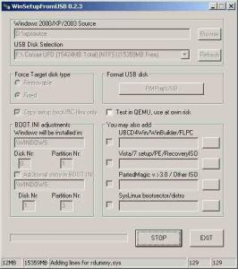

theboxhead Posted September 4, 2009 Author Posted September 4, 2009 (edited) Yes boot.ini, ntldr and ntdetect was in the root of the laptops harddisk after setup had completed.My winsetupfromUSB log:WinSetupFromUSB.zipMy ~LS\I386 folders setup_ex fileSETUP.ZIPGonna do some more research from your help.If i choose fixed option i get an error message from the program:This is the log when i try to use the fixed option:2009/09/04 15:50:23- Preparing ~BT folder completed2009/09/04 15:50:23- Launching MkMigrateInf3.cmd2009/09/04 15:50:24- Adding lines for rdummy.sys2009/09/04 15:51:00- Couldn't write to aborting...2009/09/04 15:51:00- ---------------------------------Program quited-----------------------------------------------Picture:Im so close to the perfect setup here If just the folder didn't get deleted and the boot ini file was corected i would be a very happy man Edited September 4, 2009 by theboxhead
ilko_t Posted September 4, 2009 Posted September 4, 2009 (edited) ...If i choose fixed option i get an error message from the program:This is the log when i try to use the fixed option:2009/09/04 15:50:23- Preparing ~BT folder completed2009/09/04 15:50:23- Launching MkMigrateInf3.cmd2009/09/04 15:50:24- Adding lines for rdummy.sys2009/09/04 15:51:00- Couldn't write to aborting...2009/09/04 15:51:00- ---------------------------------Program quited-----------------------------------------------...Do you select every time Prepare Boot/RC files only? I see it marked on the screenshot posted as well as in the log file.You should NOT use it when preparing USB stick. This option is to be used:1) If you want to place XP setup boot files ONLY in order to reach to the partition screen in Text mode and test of USB stick boots properly. USB stick has to be reformatted afterwards.2) If you want to place Recovery Console only.If adding another, full XP Setup, you need to answer NO when it finds another Windows source on the stick in order to rename existing ~LS and ~BT folders and patch setup and startup files.Program will fail if FIXED button is selected along with Boot files/RC only option, this is corrected in the next, unpublished yet version.Lets go through this step by step.1) Reformat the USB stick, use NTFS2) Select Windows source3) Move radio button to FIXED4) Do NOT add or select anything else yet5) Press GO6) Zip and attach here USB_stick\~LS\I386\presetup.cmd, the new WinSetupFromUSB.log, USB_root\txtsetup.sif and USB_stick\~LS\I386\setup.ex_I will check those files first then you can continue with another attempt for setup. Later on, if everything worked fine you can add UBCD4Win and Vista, it doesn't have to be done on one go. Edited September 4, 2009 by ilko_t
