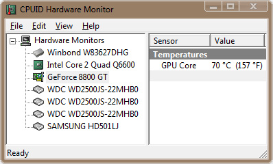

PC_LOAD_LETTER Posted July 5, 2009 Posted July 5, 2009 im not too sure that the 70degree temps hes seeing on his 8400 GS aren't typical. i get similar temps on my 8800 GT which is admittedly a different cardmy 8800 GT in an Antec Sonata:after about 10 minutes in L4D:BTW i tried the program from the other screenshots but it crashes with 'unknown architecture'

PC_LOAD_LETTER Posted July 6, 2009 Posted July 6, 2009 Sucks for you geek Not really. the thing could run at 100c degrees and as long as it doesnt melt down, i couldnt care less what the temp is. This card has been by far the best video card I have ever owned and ive owned a LOT of video cards (my first 'accerated' card was the Voodoo 2 if that gives you an idea of how long ive been buying 3d cards) With this card Ive broken free of the new-video-card-every-6 months that ive become accustomed to. Ive played Fo3, AC, Bioshock, UT3, LEGO Batman, L4D, Portal, and others i cant even remember and my 8800 which i bought in Dec of 2007 hasnt given me any issues despite its seemingly high temperature.
