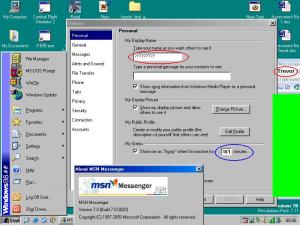

This has probably already been either stated or addressed but there is a problem with MSN messenger.
post-225284-0-21320700-1295267757_thumb.
As seen in the screenshot my name is a bunch of (?)'s and the idle time is the same.
This poses a problem in the accounts page whereby it will 'delete' your account and replace it with such symbols (luckely I dont need to edit any settings)
Also another problem (this by the way is on my laptop (as it has rp7 still... (I want this functionality in rp9 especualy whatever makes shimgvw work in rp7, but anyway...))) is that my display pic changes every startup to a different one. I first noticed this on my 'server' a while back. (before my screen blew-up)
Trev
There are various character flaws in KernelEx on Win98SE. E.g. in Firefox 3 the "..." is still replaced by a "|", which looks stupid.
