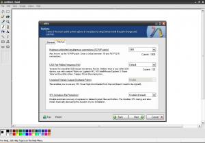

Zayne Posted February 25, 2009 Author Posted February 25, 2009 Reverting back to VMWare Workstation 6.0 worked, thanks. On the bad side, even after enabling the Uxtheme option under Patches, I'm still once again stuck with the Win98 look and WinXP along with my Zune theme are nowhere to be found (though everything else seems to work just fine). Yawn?

Zayne Posted February 26, 2009 Author Posted February 26, 2009 (edited) Yes, I don't know what's up. I enabled the Uxtheme option under the Patches tab and put every single update and hotfix in order, but I tried the new ISO I made last night in VMWare and the Themes are still missing, I mean all the themes are missing except Win98 Classic. Also, what's wrong with that all in one .NET addon? Something wrong with it I need to know about?Cheers. Edited February 26, 2009 by Zayne

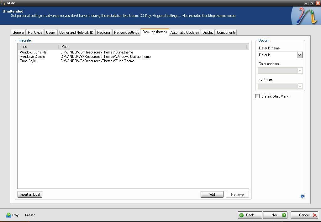

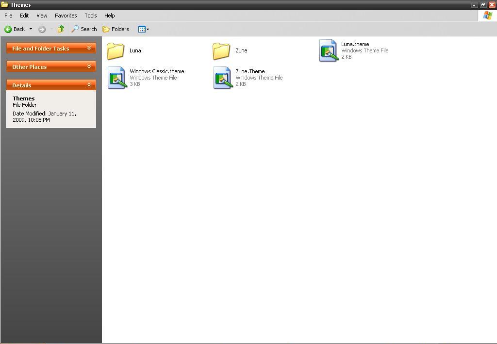

johnhc Posted February 26, 2009 Posted February 26, 2009 Zayne, please look in your C:\WINDOWS\Resources\Themes folder on your installed system and post a screen shot of a Windows Explorer view of it. Also, please post you latest Last Session.ini. I suggest you begin some experiments to narrow the problem down. First, perhaps, remove all your hot fixes and addons, build an ISO and install (I hope you are using a virtual system - perfect for this). Let us know what you learn. Enjoy, John.
Zayne Posted February 26, 2009 Author Posted February 26, 2009 Will do, I'll attach another Last Session.ini and a screenshot of my themes folder (although I think the last .ini I posted was the latest one). Stay close by because it should only take me a couple minutes to go through it all).Cheers.
Zayne Posted February 26, 2009 Author Posted February 26, 2009 (edited) Here's the requested files, including some extra screens: Edited February 26, 2009 by Zayne
johnhc Posted February 26, 2009 Posted February 26, 2009 Zayne, this tells us that your themes are getting to your installed Windows. As I understand it, when you right click your desktop and click Appearances that your themes are not there - true? Go into the Themes folder on your installed system and find one of your themes, that does not show up, and double click the .msstyles file. See if your theme will become active after you click Apply on the window that pops up. Next is to run the experiment I suggested. Best, John.
