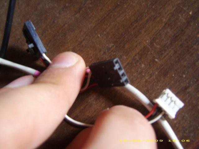

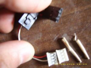

metalpower Posted May 17, 2009 Posted May 17, 2009 Very informative, good stuff!A couple of questions about the CA-42 cable (apologies if they have already been answered):- does it have to be a genuine Nokia cable, would a generic cable work?- power will come from the USB port hence no need to hook up a battery, correct?I'm still not quite sure how to affix the RX/TX wires to the pins on the HD (other than soldering), is there a standard 4-pin header that can just plug into it (what is it called)?TIA.for plug the wires to the pins on the HD my father use a old connector (audio from audio board to cd drive), the plug not enter on the hd pins, and have to remove from the plug the single female pins and put the pins on the hd sepparated with sticks (those that used to clean tooth that I not sure how is the name, I speak in spanish and those are called "escarbadientes" ) in middle of them (or those female pins can touch one to another)I attached 2 pics to see the plug that disassembled to put on the hd pins, sorry for me bad englishI used a dcu15 cable that solded to the mentioned plug.
