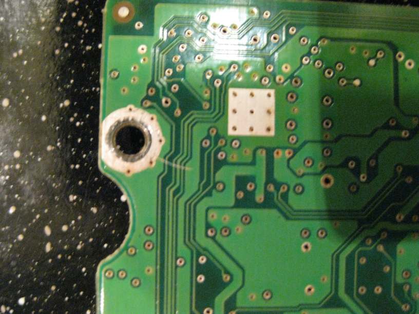

ominouswanderer Posted November 22, 2011 Posted November 22, 2011 (edited) I appreciate the responses- I apologize that it's taken me a couple days to respond.Upon taking a closer look at the PCB it looks like there is a slight scratch next to one of the screws which may be what is causing the issue. It looks like it goes right across the traces that connect to the smart motor control. I assume that the problem has to do with this since it is not able to spin up properly. In a case like this is there anyway to repair the PCB? I thought of the possibility of covering the scratch with something and then scratching away at the traces but I'm not sure on where to start as far as that goes. I also was wondering about the possibility of buying a new PCB.I've attached a pic of the scratch- anyone have any suggestions? Edited November 22, 2011 by ominouswanderer
jaclaz Posted November 22, 2011 Posted November 22, 2011 I also was wondering about the possibility of buying a new PCB.I've attached a pic of the scratch- anyone have any suggestions?Getting a "new" PCB will make you need to de-solder the "old" rom and replace it on the new board.If you think that the issue are those tracks, it is far easier to fix them than to do a chip swap.Judging from the pic, it can be fixed in no time with a fine pointed solder gun.Here is a good example of the technique involved:http://www.evga.com/forums/tm.aspx?m=185066&mpage=1Have you checked for the continuity of the traces?From they picture the scatch doesn't seem too deep. jaclaz
ominouswanderer Posted November 23, 2011 Posted November 23, 2011 I checked the continuity of the trace and it seems like there are definitely issues. The main issue seems that all of the traces are connected since the scratch goes through. Does anyone know of something that I could use to "fill" the scratch with something nonconductive so I can try and repair it? It may be beyond the point of self repair- I found a place online that supposedly will provide the new PCB as well as the chip swap for only $50 so that might be my only option at this point.
jaclaz Posted November 24, 2011 Posted November 24, 2011 (edited) I checked the continuity of the trace and it seems like there are definitely issues. The main issue seems that all of the traces are connected since the scratch goes through. Does anyone know of something that I could use to "fill" the scratch with something nonconductive so I can try and repair it? It may be beyond the point of self repair- I found a place online that supposedly will provide the new PCB as well as the chip swap for only $50 so that might be my only option at this point.You don't need anything "non conductive".If there are three "higher points" A, B, C and three traces connecting them respectively to "lower" points D, E F, i.e.:A<->DB<->EC<->Fthe above three must show continuity AND there should be no continuity A<->C or B<-C, BUT you should analyze the circuits connected to them as with a multimeter set as ohmeter it is very possible that the comtinuity "passes" through some components of the board.Since you have TWO boards, try measuring voltage levels on the two boards when connected to power.If there is actually a "bridge" between A and B or between B and C all you need is some good eyes, a magnifying glass, a steady hand and an "exacto" knife or a surgical scalpel, you simply scrape some material BETWEEN the traces.About the fifty bucks, it is a BET.I mean, these guys will surely do what they promise , but we don't really know if doing a PCB (and ROM) swap will solve the issue.As an example if your disk suffers from a head issue, you will just throw away the US$ 50 and if you want to (hopefully) get your data back you should be prepared to pay a bill in the US$500÷1,500 range jaclaz Edited November 24, 2011 by jaclaz
