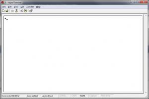

DauYing Posted December 20, 2010 Posted December 20, 2010 Hi,Where in Germany can i get a working RS232 TTL Converter.I buyed this one at Ebay: http://cgi.ebay.de/ws/eBayISAPI.dll?ViewItem&item=280558671275&ssPageName=STRK:MEWNX:ITbut it works just with 5V (Usb Voltage), powered with 3,2V (CR2032) the lopback test failed.The Pololu Deluxe Serial Adapter from Roboshop costs ~10Euro and ~30 shipping cost....Than i have a question about Hyperterminal. I'm using Windows 7 /32Bit (x86). Under W7 there is no Hyperterminal. So i download the Hyperterminal Private Editon v7.0 from Hilgrave.Works the CTRL+Z also under this Version?I don't get the F3 T> Prompt. On my attached Screenshot u can see that i just got an Arrow. Is this alright? I hope the Problem is just the wrong Voltage of the RS232/TTL Converter.
jaclaz Posted December 20, 2010 Posted December 20, 2010 (edited) Than i have a question about Hyperterminal. I'm using Windows 7 /32Bit (x86). Under W7 there is no Hyperterminal. So i download the Hyperterminal Private Editon v7.0 from Hilgrave.Works the CTRL+Z also under this Version?I don't get the F3 T> Prompt. On my attached Screenshot u can see that i just got an Arrow. Is this alright? I hope the Problem is just the wrong Voltage of the RS232/TTL Converter.Read the read-me-first AND the FGA's:leave the disk alone, try a loopback test. (this won't be affected by the "wrong" TTL levels -if any)Take into account to try powering the adapter at 3.3v (NOT with a 3V battery), but it "looks" like a 5V level TTL only ("wrong"). About the adapter, this one:http://cgi.ebay.de/FTDI-USB-UART-seriell-Adapter-AVR-PIC-TTL-RS232-/280604136107?pt=Wissenschaftliche_Ger%C3%A4te&hash=item41554f52abjusdging from it's manual:http://www.sigma-shop.com/manuals/ftdi_manual.pdfUSB to serial UART interface Boardwith FT232RFully assembled and testedWork with 5V and 3.3V Logic InterfaceThis converter provides two way serial communications signal conversion betweenthe TTL (Transistor Transistor Logic) outputto and from a personal computer USB port using virtual serial COM port.This converter can be used on any Micro controller - PIC, Atmel or other which hasTTL serial communications.The 3 pin jumper selects 5V and 3.3V.is of the "right" kind.jaclaz Edited December 20, 2010 by jaclaz
