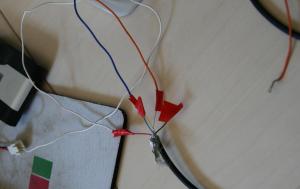

Heast Posted September 1, 2009 Posted September 1, 2009 (edited) Apparently there are different cable types with the same name: CA-42.I bought a few days ago a CA-42 cable that ultimately does not work.I bought it directly from Nokia.Features:Hello everybody. I have a Solution to get this ca-42 kind of cable to work. I have the same!Problem: Cable will not be detected from Windows when connected to the USB port.Solution: Cut off the cell phone connector, and search the RED cable. Connect the RED cable to a +5V connection (e.G. the red cable of a molex or so). I used a 5Volt FAN adapter...Now Windows will detect the CA-42 and it is listet in the device manager under "Modem".I had made the same today and now my Seagate 7200.1 1TB will work fine. Thanks to all here in this forum BTW: Sorry for the bad english :-) Edited September 1, 2009 by Heast
Heast Posted September 1, 2009 Posted September 1, 2009 Hey there good people can someone please tell me how to do a loopback test again? Please I can`t find the procedure. I`m dealing with a ca42 cable. Thanks to everzone for help. Azaktro you have made a nice description.. congratsConnect the RX and TX cable from the ca42 together. Now if you type a character in Hyperterminal it should be displayed 2 times! But before you must activate under files->properties-> setting-> asci setup -> echo typed characters locally!
