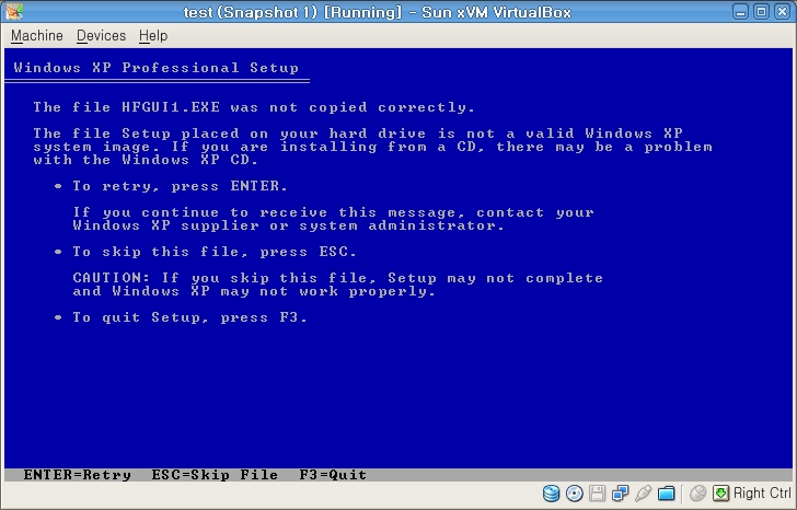

I got the problem during installing Win XP SP3 from HFSLIP
Before I got to know this wonderful script, I was the nLite users. Although nLite is also nice, it has some problems, mainly, not working with .Net Framework integration.
I needed to spend some time to get to know how to use HFSLIP, but now it makes me save more time than nLite does.
Just as indicated in the manual, I followed every step and could get the final ISO image. It looked so nice first.
However, I faced the "one" error. Still, I did not got further step so that I know just one problem by now.
Before installing this integrated Windows XP on my desktop directly, I tested it under my VirtualBox machine 2.0.4. It looked great, but I got this problem:
The file, HFGUI1.EXE is located under [sOURCE]\i386
After several trials of pressing Enter, I just decided to skip the copying step and went up for the next. Fortunately, there's no further problem.
My question is to know if I can skip the copy of HFGUI1.EXE? Or, after the installation, can I manually execute the file?
Please let me have the right answer for me.

Is there a HFGUI1.EXE file in sourcess\i386 folder? What is DNF_all.exe? Try running hfslip without DNF_all.exe and report back.
DNF_all.exe is a silent installer to all .NET FRAMEWORK, created by SNM.CMD from TOMCAT.
More info here.
Using hfslip-2.0.0pa_80630a I have similar problem with WindowsXP-KB942288-v3-x86.exe in HF folder, try remove this file and run again.

I don't have HFGUI1.EXE in my SOURCE & SOURCESS folder. But I do encounter this kind of msg once during textmode setup. I managed to trace to HFGUIRUNONCE application. My problem at that time was that the application name contains space, such as "Virtual PC 2007.exe". By removing it all the spaces, removes the error.
U can also try matching the file size on source & sourcess. I believe it is just a rename of file.
hfgui1.exe is the renamed version of dnf_all.exe. Any luck sfeone?

I'm running HFSLIP 1.7.8 on an XP-Pro install and having what seems to be the exact same problem. The program works flawlessly until I try adding files to the HFGUIRUNONCE folder. When I do I get the exact same error that is screen capped above. I've tried renaming my files but thus far it hasn't helped. Now I'm going through and adding each installer one at a time to see if it is an issue with one specific silent install. I'll keep working on it but if anyone has any tips I'd be grateful.

Every .exe that I place in the HFGUIRUNONCE is renamed to hfguiX.exe and placed in the SOURCESS\I386 and causes this error.

Interesting. Feel like testing something out? Try running modifype on the files in the hfguirunonce folder, re-run hfslip and report back. Maybe hfslip needs to invoke the modifype on the files in that folder for that function to work properly.
Yeah, Tommy is right! I remember this issue myself, as i used to use HFGUIRUNONCE along time ago, and if not running modifyPE on the exe's first, then that exact error came up(Tommy also helped me with that issue back then!)...
It's because if Windows is copying files during setup, then setup calculates the exe's checksum and compares it to the PE checksum stored in the exe's header, but on e.g. 7z sfx's, then the PE checksum in the header comes from the 7zs.sfx module(which is the actual header on 7z sfx's) and hence, will always be the same value and not match the actual exe's checksum, as the real checksum would obviously vary from exe to exe...

I can confirm that you are both correct. Running the modifype on all the switchless installers I created has solved the problem, I no longer get that error message. Everything seems to be installing perfectly now.
From what I've read on the net there are really a few things that can cause this error. In my case this was the solution. This same error can occur when a computer has any of the following: malfunctioning PSU, hardrive, RAM, CD/DVD drive or a bad install disc. In my case none of these five made sense since it was happening on multiple machines. I only mention it so if someone has this issue in the future and this either doesn't apply to them or fails to resolve the issue for them, they can look into these other possibilities.
