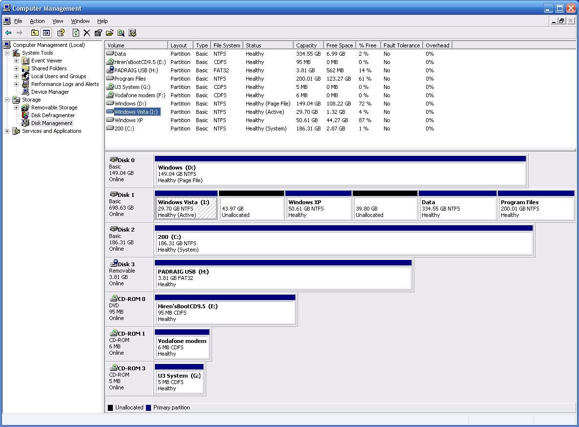

At the moment the problem is that Windows XP (I have a dual boot and this is the only one I can access) mounts one of my hard drives as read only. I believe this is down to the fact that there seams to be a problem with the MFT on the Vista partition of this hard drive.
I'll go through how I got to this situation!
I used Acronis Disk Commander to create some free space on my hard drive so that I could install Fedora Core 8. However during the installation of Fedora disk druid was not able to use the hard space, though this was strange I just accepted it and booted back up to windows and used Disk Commander to create a 40Gb extfs partition (mounted as ‘/’) and a 4Gb Linux swap partition. When I again tried to install Linux (selecting the’/’ partition in disk druid) it warned me that there was a problem with the drive and it would have to erase all data. Stupidly I said Yes (it was late and night and I should have been paying more attention), and immediately realising the stupidity of what I had done I rebooted. Lo and behold my partitions were gone.
Handily I had a version of Ultimate boot disk at hand, so using TestDisk I recovered the partition table, wrote the recovered table to the MBR and then rebuilt the corrupted BootSector on my Vista drive (the first and active partition on the drive I had formatted). However it still would not boot up (even though the MBR was fine, as it got to the screen offering me the choice of XP or Vista). I then tried to repair it with the Vista install disk, but that failed.
Luckily my XP partition is on a different drive, so I altered the bois so that the XP drive was the fist drive to be booted and managed to successfully boot into XP. Now here is were I have a problem that I can’t seam to fix.
XP seams to be mounting the problem drive (the one I recovered the partition table on) in read-only (write-protected) mode, and none of the NTFS partition are showing up in ‘My Computer’ I then went to My Computer->Manage->Disk Management and the problem drive and all its partitions are listed there (all as healthy) as the screen shot below shows.
However, when I assign a drive letter to any of the drive’s, although it assigns it properly I still cannot see the drive in ‘My Computer’, however I can access the drives contents by right-clicking on them in ‘Disk Management’ and clicking open, I can also access them through Command Prompt. I think the reason that I cannot access them through ‘My Computer’ is because it is mounted read-only the assigned drive letters won’t ‘stick’.

I have tried assigning drive letters to the drive using Acronis Disk Commander, but as XP mount the drive read-only again the drive letters do not stick. Also I have rebuilt the BootSector and checked the MFT using TestDisk again, but the problem still remains.
This problem drive also contains 3 other partition (primary) which contain a lot of important information and also contains my ‘Program Files’ directory (I install all my programs to this drive instead of the usual C:/Program Files), so I really want to get it usable again. Since I can see and access all the partitions and information using ‘Disk Management’ I know that all the data is OK, I just need windows to stop mounting it read only. I think this read-only problem is the reason that the Vista Start-up Repair failed as it probably mounted the drive read-only as well.
Can anyone help me get this drive either mounted read/write in a repair console so that I can run chkdsk /F, or else mounted read/write in XP. I don’t mind losing my Vista partition (although as it seams to be structurally intact it should be fine to boot to still), but as I don’t have space to copy all the data on this drive to (it about 700Gb of data) I really need to make this disk read/write so I can use the data (epically my ‘Program Files’ directory).
