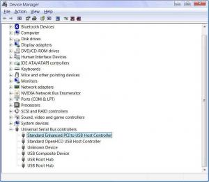

Here's my Device Manger with the "Enhanced Host Controller Interface (EHCI)" (USB 2.0) highlighted (in light blue). Note that on my board, Hi-speed USB (2.0) is called "Standard Enhanced PCI to USB Host Controller" and my Full-speed USB (1.1) is called "Standard OpenHCD USB Host Controller".
As Tripredacus said there is no physical difference when you look at them, looking in device manager is the only way (and plugging something in as Tripredacus also mentioned). I think its worth contacting Acer support to confirm that your hardware supports USB 2.0. I would be surprised if it didn't but you never know. Acer should be able to advise you where you find the USB 2.0 options in BIOS too (or maybe even google?) A BIOS update may help but I'd contact Acer first myself. You've paid for extra warranty so might as well use it!
I think you need to find out more about your BSOD too. The fact that is happening suggests to me its something deeper than a simple case of no USB 2.0 support (ie actually something wrong). Enable a full error dump and turn off auto restarts on BSOD (so you can write down the full STOP code). Then try to make it do it and when it does it, upload your dump here and try to attract the assistance of some of the hardcore tech heads (error dump analysis is way out of my league!)

....I checked thru device manager found these drivers for USB:
SIS TO PCI converter
Enhanced USB driver. and few others .... (if you want i can upload its screenshot)
