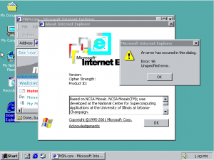

Fudeba Posted June 23, 2007 Posted June 23, 2007 (edited) I tried to use HFSlip 1.5.0 but this not integrate correctly Internet Explorer 6 SP1. HFSlip 1.4.5 work perfectly.See error in this image:Other: My RegTwak also not working in 1.5.0. I have place regteak.reg in folder HFSVCPACK.Another question: What best way to place and remove icons in a start menu from HFSlip during install?My HFSlip LOG:HFSLIP_LOG.TXT Edited June 23, 2007 by Fudeba
Tomcat76 Posted June 23, 2007 Posted June 23, 2007 You have hotfixes for IE5, IE6, OE 5.5 and OE6 in your HF folder. Please remove those for IE5 and OE 5.5.Also, when slipstreaming IE6 but not the latest Windows Script 5.6 package, you need Windows2000-KB917344-56-x86-PTB.EXE and not Windows2000-KB917344-x86-PTB.EXE.
Fudeba Posted June 23, 2007 Author Posted June 23, 2007 Hmmmm.... very strange! This related updates are reported on here:http://users.telenet.be/tc76/winup/_win2k.htmlBut, i removed now hotfix for IE5 and OE 5.5 and replaced KB917344 to KB917344-56-x86.In this moment HFSlip compiling and sliptream W2k.I go to install the W2k in the VPC and place the results here in some minutes.Ah... any tips from problem with regteak or this is related to problem with IE6 sliptstream?And from better way to add/remove/replace icons on start menu during install?Thanks!

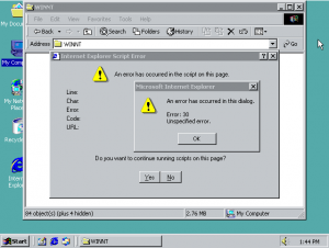

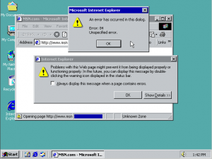

efrain Posted July 31, 2007 Posted July 31, 2007 Hi guysIm having a trouble integrating IE6 to my Win2k. I followed the instructions on how to integrate IE6 from http://www.vorck.com/2ksp5.html the installation of win2k works perfectly fine but when I try to look the version of IE6 a error message pops up saying Error: blah blah blah. Then I open the Winnt folder I recieved a error message again.I dont know what causing this problem.I hope you guys can help me.Log_file.txt
Tomcat76 Posted July 31, 2007 Posted July 31, 2007 I have replied to your IM but I'll copy it here.I see a few problems with that log. First off, you are slipstreaming IE5 and IE6 updates together. Secondly, there are several unsupported hotfixes. And third, you are including an update for MDAC 2.8 SP1 but you are not slipstreaming MDAC 2.8 SP1 (MDAC_TYP.EXE). Please use my hotfix list and don't include any other updates.Please upgrade to the latest version of HFSLIP too.
efrain Posted August 1, 2007 Posted August 1, 2007 I see, thats the one causing the problem.. Ok, ill download the latest upgrade of hfslip. Ill follow your advice. Thanks for your help!!
