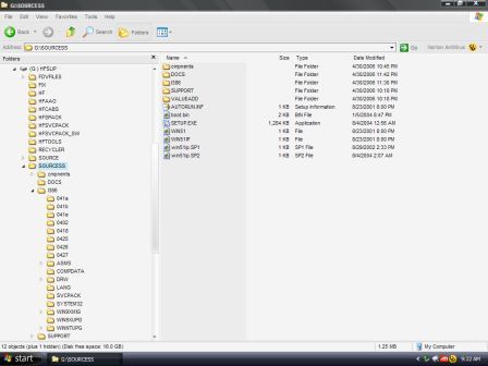

  20. hi again sirs (Tomcat & tommyp)! as always, many thanks for your feedback! i just want to share what i've accomplished over the weekend (i was still using 503c though to make isos) ... here's what i've found out: (1) here are the added folders to the i386 dir + their contents: 041b D:\SOURCESS\I386\041b\wmpshell.dll.mu_ D:\SOURCESS\I386\041b\xpsp2res.dl_ D:\SOURCESS\I386\041b\mlang.dll.mu_ D:\SOURCESS\I386\041b\wmm2res2.dll.mu_ D:\SOURCESS\I386\041b\wmploc.dll.mu_ 041e D:\SOURCESS\I386\041e\wmpshell.dll.mu_ D:\SOURCESS\I386\041e\xpsp1res.dl_ D:\SOURCESS\I386\041e\xpsp2res.dl_ D:\SOURCESS\I386\041e\browselc.dl_ D:\SOURCESS\I386\041e\inetres.dl_ D:\SOURCESS\I386\041e\mlang.dll.mu_ D:\SOURCESS\I386\041e\mshtmler.dl_ D:\SOURCESS\I386\041e\msoeres.dl_ D:\SOURCESS\I386\041e\shdoclc.dl_ D:\SOURCESS\I386\041e\wab32res.dl_ D:\SOURCESS\I386\041e\wmm2res2.dll.mu_ D:\SOURCESS\I386\041e\wmploc.dll.mu_ 0402 D:\SOURCESS\I386\0402\wmploc.dll.mu_ D:\SOURCESS\I386\0402\wmpshell.dll.mu_ D:\SOURCESS\I386\0402\xpsp2res.dl_ D:\SOURCESS\I386\0402\mlang.dll.mu_ D:\SOURCESS\I386\0402\msi.dll.mu_ D:\SOURCESS\I386\0402\shdoclc.dl_ D:\SOURCESS\I386\0402\wmm2res2.dll.mu_ D:\SOURCESS\I386\0402\wmm2res.dll.mu_ 0418 D:\SOURCESS\I386\0418\xpsp2res.dl_ D:\SOURCESS\I386\0418\mlang.dll.mu_ D:\SOURCESS\I386\0418\shdoclc.dl_ D:\SOURCESS\I386\0418\wmm2res2.dll.mu_ D:\SOURCESS\I386\0418\wmm2res.dll.mu_ D:\SOURCESS\I386\0418\wmploc.dll.mu_ D:\SOURCESS\I386\0418\wmpshell.dll.mu_ 0425 D:\SOURCESS\I386\0425\wmpshell.dll.mu_ D:\SOURCESS\I386\0425\xpsp2res.dl_ D:\SOURCESS\I386\0425\mlang.dll.mu_ D:\SOURCESS\I386\0425\shdoclc.dl_ D:\SOURCESS\I386\0425\wmm2res2.dll.mu_ D:\SOURCESS\I386\0425\wmm2res.dll.mu_ D:\SOURCESS\I386\0425\wmploc.dll.mu_ 0426 D:\SOURCESS\I386\0426\wmpshell.dll.mu_ D:\SOURCESS\I386\0426\xpsp2res.dl_ D:\SOURCESS\I386\0426\mlang.dll.mu_ D:\SOURCESS\I386\0426\shdoclc.dl_ D:\SOURCESS\I386\0426\wmm2res2.dll.mu_ D:\SOURCESS\I386\0426\wmm2res.dll.mu_ D:\SOURCESS\I386\0426\wmploc.dll.mu_ 0427 D:\SOURCESS\I386\0427\xpsp2res.dl_ D:\SOURCESS\I386\0427\mlang.dll.mu_ D:\SOURCESS\I386\0427\shdoclc.dl_ D:\SOURCESS\I386\0427\wmm2res2.dll.mu_ D:\SOURCESS\I386\0427\wmm2res.dll.mu_ D:\SOURCESS\I386\0427\wmploc.dll.mu_ D:\SOURCESS\I386\0427\wmpshell.dll.mu_ (2) on the early stages of slipstreaming, HFSLIP reported that a particular KB added some folders; i tried taking it out though but the same additional folders (above) still showed up in SOURCESS (3) i think i already resolved my XPize issue ... it was totally my bad ... ... i was using an XPized SP2 SOURCESS (as XPize has a feature to create a bootable XPized ISO) ... when i just used SOURCESS from HFSLIP, T-13 didn't show anymore the installation prompts of XPize ... oh well, a lesson learned! (4) would RyanVM's Windows XP Post-SP2 Update Pack work hand in hand with HFSLIP? you see, in 1 of my experimental builds, i checked the contents of the package & removed from the HF directories those files that are in the cab file ... now when i ran qfecheck, it only shows those that were in the addon pack ... & not those in the HF folders ... i've attached a text file for your reference (5) these 2 don't seem to do anything for the system: Themes_rytukz_VistaCG_addon_v1.0.cab Themes_rytukz_VistaCG_addon_v1.1.cab ... i tried each 1 at a time & i tried even having both ... to no avail (no theme added for me to use) ... checking both files though do not seem to show any pic file ... btw, 1.0 has a bigger size compared to 1.1 due to the difference in compression (6) would it be possible to replace snap ons like dfrg.msc via HFEXPERT\APPREPLACEMENT? (7) would the reference (or update at least) for slisptreaming CODECS be applicable to XP too? apparently, the discussion in a different thread is for 2K (8) is there a difference between letting HFSLIP integrate SP than doing it manually? (9) just a follow up, i know it might be too much to ask but could the entire process (from start to finish) be generated as a separate report too (so that we can see all the messages/errors/processes that have transpired during the run of HFSLIP) (10) lastly, about timing the slipstreaming process, would it be alright to request for the start & end times be included in the log as well? cheers! hotfixes.txt HFSLIP.txt

  23. I have not added much add-ons except for the ff: VistaCG Theme [v0.98], Microsoft MakeCab v1.00.0601, XnView Complete v1.82.4, Reboot Into Safe Mode v1.0 ... please see the pic attachment for the extra folders thanks for the clarification Super-Magician … I was just thinking that replacing it probably with .exe would make it work Is qfecheck capable of detecting it? As far as I know, it is only installed if Windows setup thinks it's necessary. It's just a driver update. Are you having audio problems?If installed separately, High Def Audio shows up in Add-Remove programs list … if included in the HF dir, it doesn’t show when checked via qfe … Please know though that I‘m not having any issue w/ audio Really strange. SVCPACK.INF doesn't contain the switches even though they are specified in XPize.txt. Can I have a look at your xpize.txt file? pls see attachments sir … I’ve included both the SVCPAK & SYSOC.infs … please know I am not having problems w/ the installation … it’s just that I hope I wouldn’t have to answer follow the prompts anymore at T-13 got the latest already … let me try this ver J just the same pls see the pic attachment for the error thanks guys! this is nothing much ... but may be worth a look ... "Founding" xpize.txt infs.7z
  24. hi all! been away for quite a while ... ;( just wanted to share that all seems fine with those that i have slipstreamed ... only a few things to share though: 888111 doesn't seem to recognized when ITs presence is validated via qfecheck ... it does not show in the report a particular theme addon (VistaCGI if i recall it right) from rynavm prevent the OS from installing ... it shows that line 1 of textsetup.sif is not valid ... there seems to many directories (usually the very 1st folders) added to my i386 directory (i.e., 041, 043, & the like) ... where did these come from? btw, XPIZESW=/S /notask still didn't work for me. XPize installation still showed up at T-13 & i still followed the prompts. may i just ask what the SW is for? thanks!
