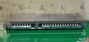

  1. Here's another close up with mm scale. The external-facing socket is identical in size. Actually, seems to be identical component. UPDATE: This is now probably moot, after the following: I thought the connectors matched, but didn't think it would physically fit. But I gave it a try and it does... And now I notice some holes in the mobo and the base that would allow bolts to secure the drive. So, the obvious solution that I had dismissed is actually the answer. I plugged in some old SATA drives I had lying around and they heated up and spun, but couldn't see any sign the device had recognised them. But one step forward, the connection problem is solved at least.

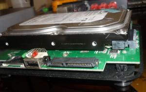

  2. Enough space for a desktop 3.5" drive. I don't have any 2.5" to try. Here's some more photos: http://tinyurl.com/n8kxstu I'll open it up agan and measure it exactly later.

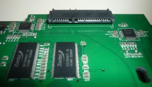

  3. I've got a media player with minimal documentation. The manual says that it supports SATA hard disk, but no details. Inside there is enough room for a hard disk, and a socket that I presume is a SATA connector. (top side image below) But it's not a conventional motherboard SATA socket. Can anyone ID the kind of socket it is and the cable it needs to connect a hard disk? PS. I guess it's a "15+7 22 Pin SATA Serial ATA Male To Female Data Power Cable" as here: http://www.lunashops.com/goods.php?id=404
