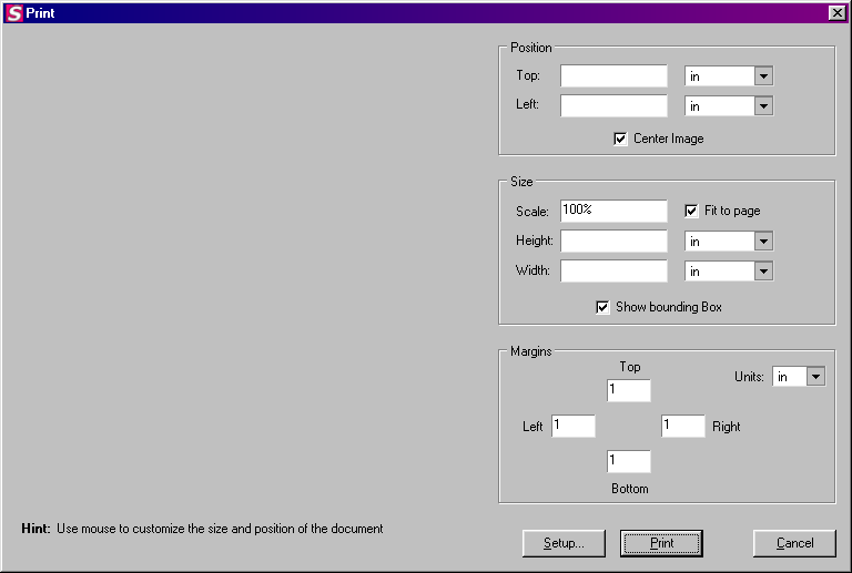

  10. I'm not sure whether fireshot uses Firefox's intern printing engine. Fireshot seems to work like a graphic program, which takes a screenshot (like Alt+PrintScreen buttons pressed). Fireshot has own *.dll's: fsaddin.dll, Sss.dll, SSSLauncher.dll. Are there other known extensions for firefox, which work similarly? Maybe it could even be possible to create an own printing extension, but that could be very tricky... Yes. The error message"There is no default printer currently selected" seems to be sent by the file sss.dll, which belongs to fireshot: After that I get the following:
  11. A long time ago I asked here whether somebody was able to print directly from Firefox 3.* under Win98SE with KernelEx. It seemed that nobody has/had a really satisfiying solution. Some days ago I found an extension called "fireshot" which could(?) be a possible solution, because it seems that it has its own printing engine(?). But its printing function doesn't work: If I try to print I get an error message: "There is no default printer currently selected." But I have a default printer! So the problem seems to be that fireshot can not find my printer. I added some registry hacks, but with no success. Is anybody able to print with Fireshot in Win98SE? Furthermore I found another extension which could maybe be helpful; called "Capture & print". But this does (generally) not work with Firefox3.*. Could it be possible to edit its source code to make it compatible with Firefox3?
