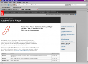

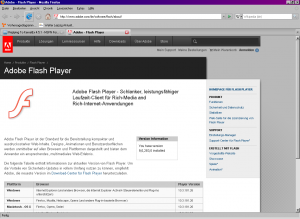

  5. I have tried different flash 10 versions - all with the same result: A white area instead of flash box. I tried even to disable Java to exclude it as reason for the issue. For results on adobe's test page see the images attached below. Both images show adobe's test site, one with Flash 10 and the other one with Flash 9. This is all with disabled Java. Flash 9 shows the version Info, Flash 10 does not so. I dimly remember that I had installed an early Flash 10 version a long time ago, and that it worked at that time (without KernelEx and not stable, but I had a Flash box generally). Could removed Windows components (with 98Lite) be the reason? I have e.g. removed Windows' Shockwave Player, MS-XML-Support, msinfo and some other. Is any of them required for Flash 10?
