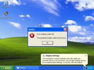

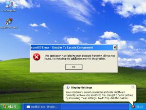

I stated earlier that I add your addons with Signet's Integrator, then I run the build through nLite, that is why I asked if you also wanted the Integrator log. Of course the nLite config file will not show something that has already been integrated with the Integrator. If I add just the new 2.1.9 addon pack (with the integrator) and then run it through nLite using the config file I attached, everything works perfectly. If I add the Uber pack version 9.9 (again with the Integrator - either at the same time as the update pack or as a seperate run after the pack has been added) and then run it through nLite I get the errors as shown. Post #21 does make this fairly clear and also states that I don't think either nLite or the Integrator is to blame. Possiblly the Uber pack is also not to blame on its own because few other people seem to have any problem. But when nLite is used after the Integrator with ver 9.9 it breaks my install and version 9.7 does not so I don't know what is going on? I can reproduce the error (as per the screenshots taken last night) every time. It's not a biggy anyway cos I can easily drop back to 9.7, which has always worked perfectly but just thought you might like to know there is a potential issue. After all my setup can't possibly be totally unique.
OK - just had the same error again. Attached are two screengrabs from VMWare, first is of the first error, clicking on OK then gives the second error message. Config file from nLite also attached. Having problems getting the setuperr log out of VM Ware - will have another go tomorrow, it is now coming up to ¼ to 2 in the morning. LAST_SESSION.INI
Hi Kel - I'm back home tonight and will reproduce the errror and post the info you have asked for. I'm using XP Pro with English UK as the language. Is there anything else you need to see besides the setuperr log and my session.ini file? I am using Signet's Integrator to integrate Ryans 2.1.9 update pack and the three addons that I mentioned - then I run nLite and use nLite to make the final ISO. Is there anything from the Integrator log that you need?
If I don't use any addons everything works perfectly. As soon as I start using addons it fails so I set about trial and error to find the cause and have carried out over 50 tests last week, each taking around two and a half hours so I have spent a lot of time on this. I use a number of tried and tested packs as routine and this is one of them which hasn't caused a problem before so I jsut kept adding it and kept getting problems. Then I took a step back and just added any packs that had been updated or were new since the 2.1.8 build that worked and it failed. So then I took out the ones I had used previously and just put brand new ones in and it worked. This suggests it is an updated pack. I then try again using packs that I have tried before with success but have been updated and use 3 packs Kels Uber pack version 9.9 Kels runtimes pack 2.51 (I had been using 2.3) and Kels Vista drive indicator v1.8 (been using 1.6 previously) I get the error - so it suggests that one of the above is causing it. I drop back to version 9.7 of the Uber Pack having noticed that someone else mentioned a problem with 9.9 in nLite and everything works perfectly. I try using nLite to do everything (including the 9.9 pack) and get the error. I am only reporting an issue I am getting in the same way I have reported other problems. An example is the Luna Royale pack that caused issues made by Ricktendo. Loads of downloads and nobody had reported a single issue with it until I posted, then others reported the same issue and Ricktendo himself replies to say he was grateful cos he couldn't track down which of the addons was breaking his install! Based on the above I felt it necessary to mention what I thought was causing the problem in my case, that way everyone benefits. It is not a dig at anyone - it is the result of a huge amount of testing which has taken over 100 hours of my own time. In a similar way I am testing the new office integrator with Signet, which had issues preventing it working in the first releases - but people responded saying it worked perfectly for them!!
It's not nLite - as I mentioned in an earlier thread. I have no identified the addon that is responsible for breaking all my installs. I did try using nLite on its own and it worked perfectly. I tried integrating Ryans latest pack with the Integrator then using nLite with my tried and tested configuration and it works perfectly. It was only when I started using addons that I got the issues and after hours and hours of testing I am fairly certain that it is Kels Uber addon pack V9.9 that is breaking it. If I leave it out everything works fine, soon as I add it the install goes all screwy. I know it is nothing to do with your original problem but anyone seaching for this error message will find this reply which may now help them. Good luck with your issue.
