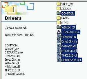

Stream2k Posted November 25, 2003 Posted November 25, 2003 Don't know if this will work for everyone but it does for me. I copied the root files, and two directories ('winxp_2k' & 'common')from //Audio/Drivers on my Soundblaster Live CD into a directory called 'LiveDrv' on my XPCD as shown below. The /s switch on CTZAPXX.exe appears to give a silent driver install. I call this up out of my main_batch.cmd file as shown below:start /wait %systemdrive%\Drivers\Sound\Creative\LiveDrv\CTZAPXX.exe /sNo surround mixer with this, just the drivers, but that's all i want :-) Only downside is that it takes 34.5MB of my CD up I'm sure i (you) could trim this down Hope this helps someone. Great forum & my 1st post

Igor Posted December 2, 2003 Author Posted December 2, 2003 Don't know if this will work for everyone but it does for me. I copied the root files, and two directories ('winxp_2k' & 'common')from //Audio/Drivers on my Soundblaster Live CD into a directory called 'LiveDrv' on my XPCD as shown below. The /s switch on CTZAPXX.exe appears to give a silent driver install. I call this up out of my main_batch.cmd file as shown below:start /wait %systemdrive%\Drivers\Sound\Creative\LiveDrv\CTZAPXX.exe /sNo surround mixer with this, just the drivers, but that's all i want :-) Only downside is that it takes 34.5MB of my CD up I'm sure i (you) could trim this down Hope this helps someone. Great forum & my 1st post Thank you very much
